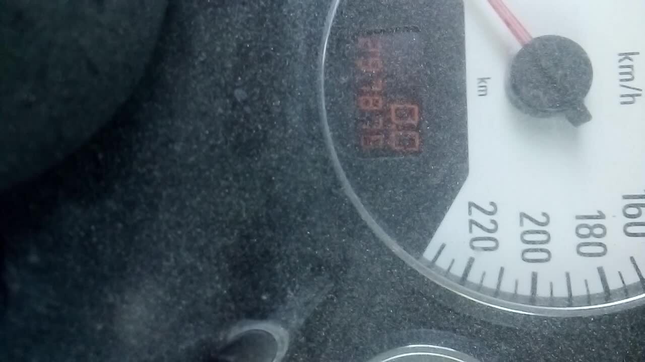

It has it in the throttle body. I cleaned before still problem. It has 30 psi at rail. It supposedly has to have 55. There is a broken hose line.

Here it is .

If the fuel pressure it that low, chances are that is the problem. Which hose is damaged? Is there a leak?
