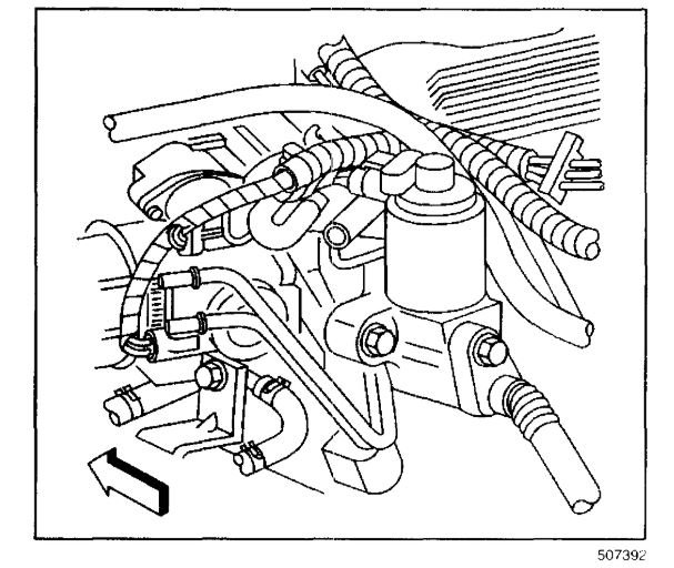

P1404 Exhaust gas recirculation (EGR) valve not fully closing. Wiring, poor connections, EGR valve position sensor, EGR solenoid (Exact Code being pulled).
Jun 18, 2019 at 6:21 AM
The most common issue with the 1404 is the EGR valve.

- Inspect for excessive deposits on the EGR valve pintle or seat. Remove the EGR valve and check for deposits that may interfere with the EGR valve pintle extending completely or cause the pintle to stick.

Thanks, this is really helpful, I appreciate it. I will go into more depth on this reread through as I try to find the EGR valve and determine if its broken or clogged. The problem isn't intermittent, although the car does (and did) have a problem starting (which is why the fuel pump was replaced) and even after replacing the fuel pump, sometimes it fails to engage, causing me to sit there and ensure that the fuel pump actually turns on when turning the car on.
