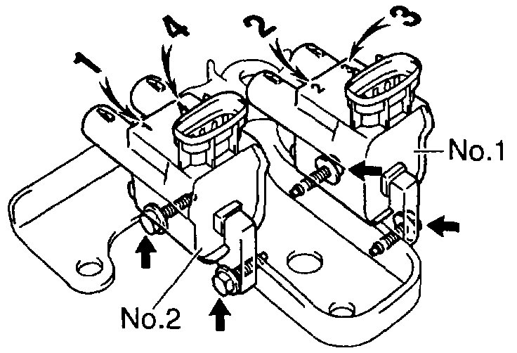

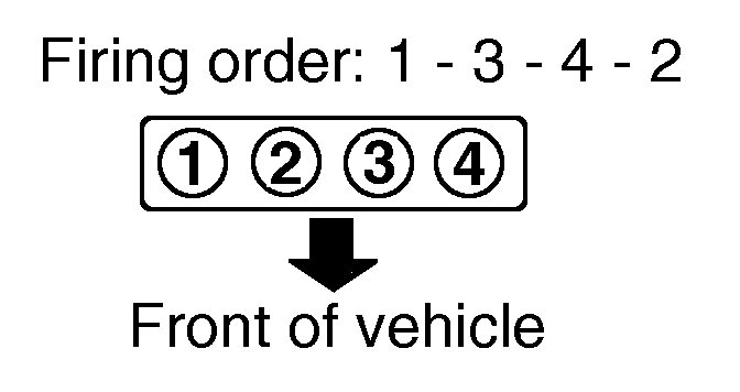

I got my spark plugs and wires changed and then came home. Then the car turns over but will not catch. So how do I fix this problem? Then the fuel pump come on when I try to crank it.
Thursday, December 13th, 2018 AT 10:38 AM
11 Replies
  • 109,885 POSTS
Hi and thanks for using 2carpros.com.
First, make sure you have replaced the wires to the correct cylinders. I attached a picture of the coil and the firing order. Make sure each wire from the coil is going to the correct cylinder.
Also, make sure the connectors are secure at the coil and nothing is loose or any of the pins in the plug are damaged.

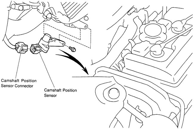

I didn't change the coils at all. And when I scan it now it said map sensor and camshaft position sensor.
Saturday, December 15th, 2018 AT 10:38 PM
  • 109,885 POSTS
Hi again,
As far as the codes, make sure you didn't accidentally disconnect them or move something that may have partially disconnected them. It would have been easy to do when you were working on the vehicle because of their locations.
I attached pics of both.
Let me know. Also, if you haven't checked for spark, I need to know if you are getting it.

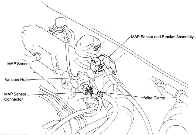

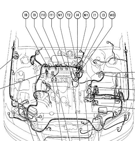

Where is the map sensor located. Also, I got to change the position sensor and my plug aren't wet.
Monday, December 17th, 2018 AT 4:24 AM
  • 109,885 POSTS
Welcome back:
Are you getting spark? If the plugs are getting spark and are dry, then there is no fuel to them. If it is getting fuel and spark, it should run. If the plugs are dry and no spark, then again no fuel. As far as the MAP sensor, see the attached picture and locate M1. It points to the MAP.
