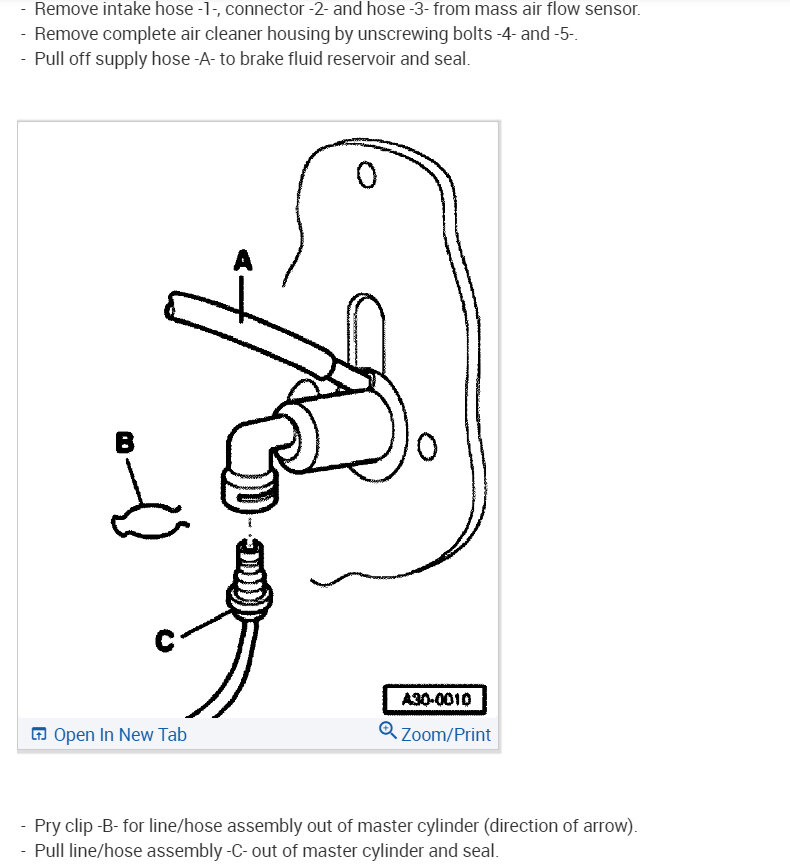

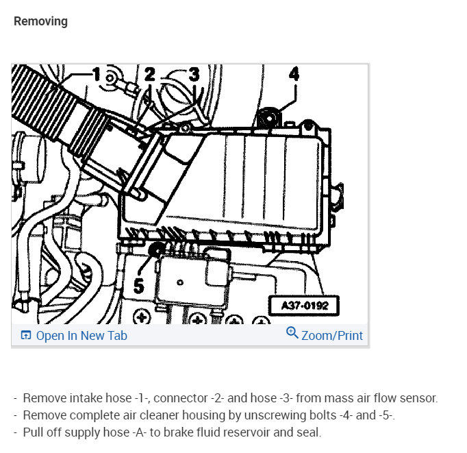

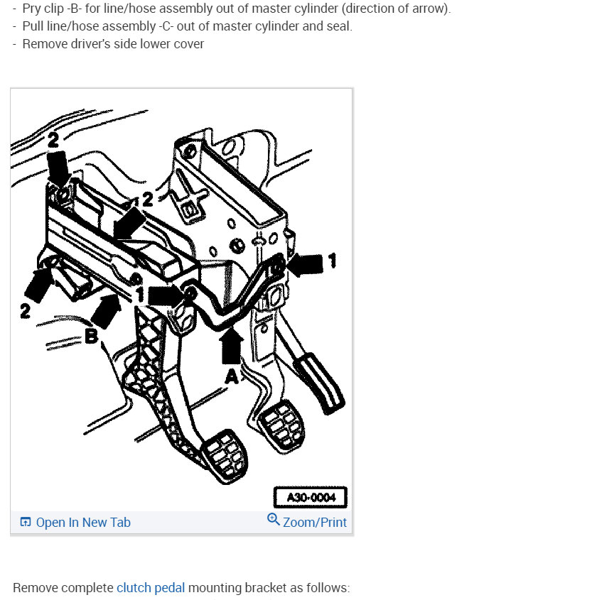

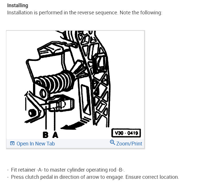

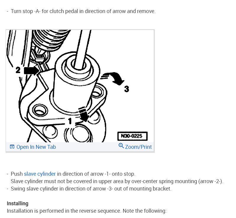

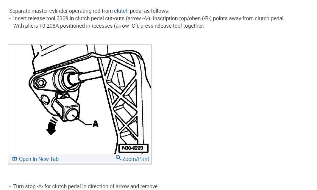

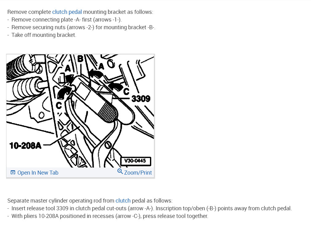

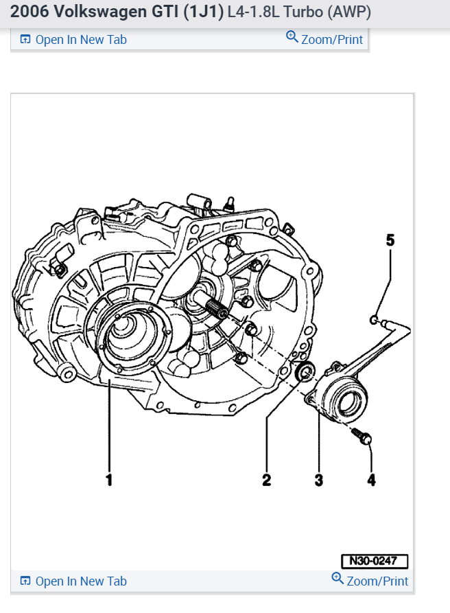

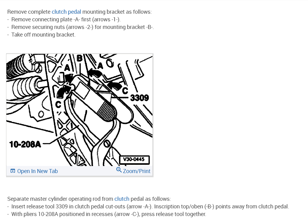

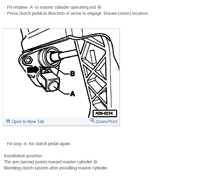

The clutch secondary cylinder is inside the transmission bellhousing. Do you see any fluid dripping? It could be the clutch master went out if no fluid is leaking, here is a guide that can help, and I have included how to change out the clutch master as well.
https://www.2carpros.com/articles/clutch-doesnt-work-sometimes-or-not-at-all
Once installed pump the clutch pedal about 50 times to get the air out, the system self-bleeds. Check out the images (below). Let us know what happens and please upload pictures or videos of the problem so we can see what's going on.
