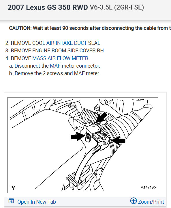

That could be, does the engine continue to run as long as you are spraying fluid? If so, then it can be the fuel pump, did you clear the codes and then crank the engine over to see what codes come back, we need to narrow the problem down a little more.
P0102 - Mass Air Flow (MAF) Sensor Circuit Low Input
I would also unplug the MAF sensor to see if it starts. Check out the images (below). Please let us know what happens.
