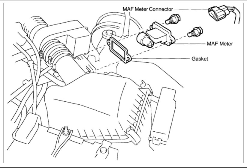

Have replaced; fuel injectors, fuel pump, fuel filter, air filter, PVC valve, spark plugs, plug wires, cam position sensor, all three ignition coils, all oxygen sensors. I have removed and cleaned the MAF sensor and the idle air solenoid valve. I have checked the codes with my code reader and have not gotten any. But I continue to have rough running and coughing from idle to acceleration. Seems to buck and surge when cruising at steady speed. Intermittent symptoms. Will easily rev to 6000 rpm's and have rocket-like acceleration after stumbling until about 2000 rpm's. I am going crazy trying to figure this out! Please help me!

It sounds like the MAF sensor is out. Cleaning these only helps sometimes if they are too far gone they will not come back. Here is a guide to help other see what you must do to fix the problem.
https://www.2carpros.com/articles/how-to-replace-a-mass-air-flow-sensor-maf

Are all of these symptoms consistent with this diagnosis? I am seeing other mechanics saying to check the IAC and TPS. Does the MAF sensor deteriorate slowly, or suddenly? The surging has been happening for quite a while, but the sluggish acceleration and coughing has been only recently.

It goes bad slowly and than it gets to the point that is effects the engine. It kind of sounds like you have a camshaft lobe that is flat. I would do a compression test to see if the engine is okay so we are not throwing parts at a bad engine.
Take note of the spark plug color from each cylinder.
Also, if you can take a video of the problem and upload it that way I can see what is going on.

Compression check already done. No problem. All new plugs, coils, wires, O2 sensors, cam sensor, etc. Please reread my original posting. I might add that the car was my elderly mother's car, and sat for extended periods outside her home in Sarasota. Salt air? I'm shooting in the dark, very discouraged. Such a nice, low-milage car and I can't trust it for my wife to drive to work!

I would like to see and hear when the car is having the problem. Without any codes it will be a bit of an investigation especially an intermittent problem. as you already know so as much information you can transfer to me the better a video is a great way to do that.
So this is what I see as on the plate so far. Crankshaft angle sensor, shorted injector or bad PCM.
We will figure it out. Please remove all injector connectors and check the ohms readings, they should be super close to one another.
Here is a guide.
https://www.2carpros.com/articles/how-to-test-a-fuel-injector

I replaced the MAF sensor with NO apparent change. I was hopeful when I discovered that the MAF sensor was not gasketed and I couldn't tighten it any further since it has shoulder bolts holding it in place. I tried sealing the old MAF with a gasket and a little sealant (silicone rubber). That didn't do anything. I then replaced the MAF with the gasket and that also made no difference. The car is running even worse, grey smoke when starting (not every time), hesitation, sputtering, coughing, surging. I'm at my wits end! Would you please tell me how to send you a video if you think that it would help.

I would tend to agree with a MAF fault. MAF are sensitive components and specific to each engine. Did you get a correct replacement part?
If you have a scan tool you could try reading the TPS voltage to check if it is working smoothly when throttle is opened and closed.
