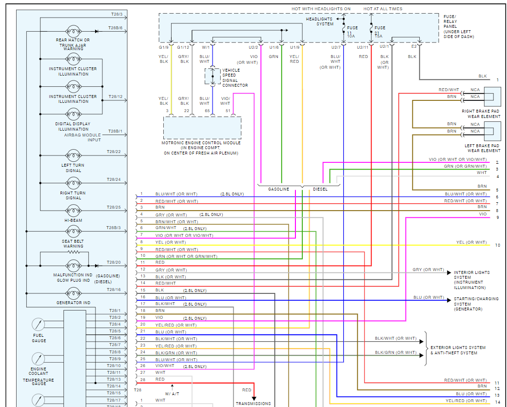

Golf MKIII Cluster wiring diagram
Hello, i need to know which pinout is which for the following:
Power
Ground
Speedometer
Tachometer
Transmission gauge
Thanks

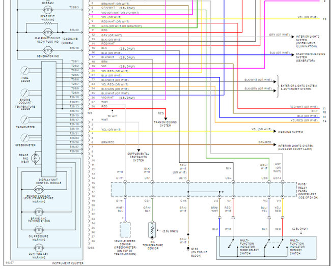

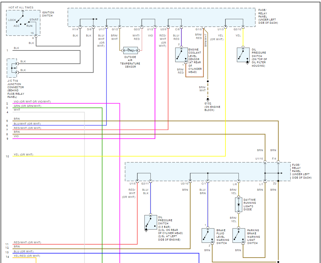

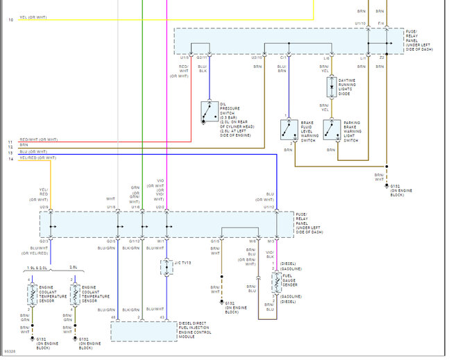

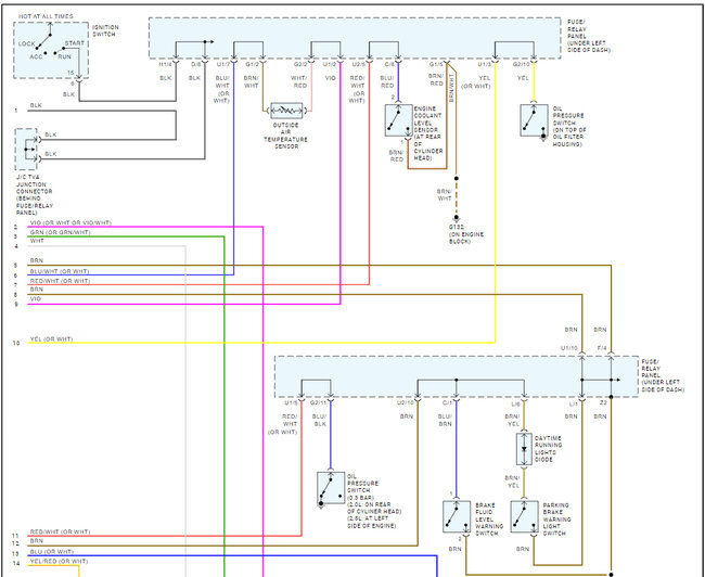

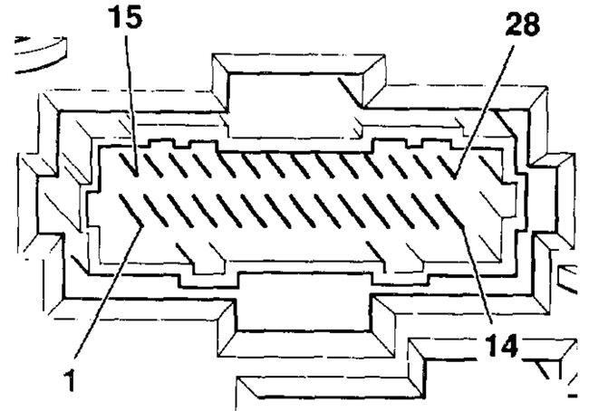

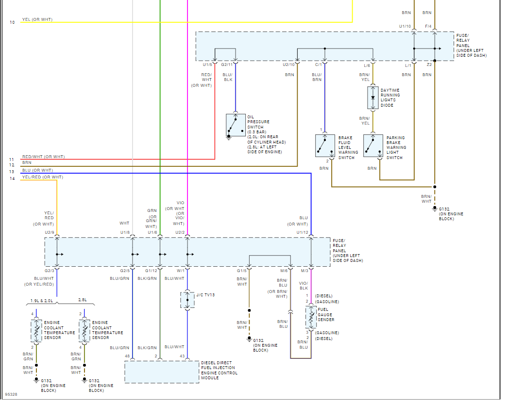

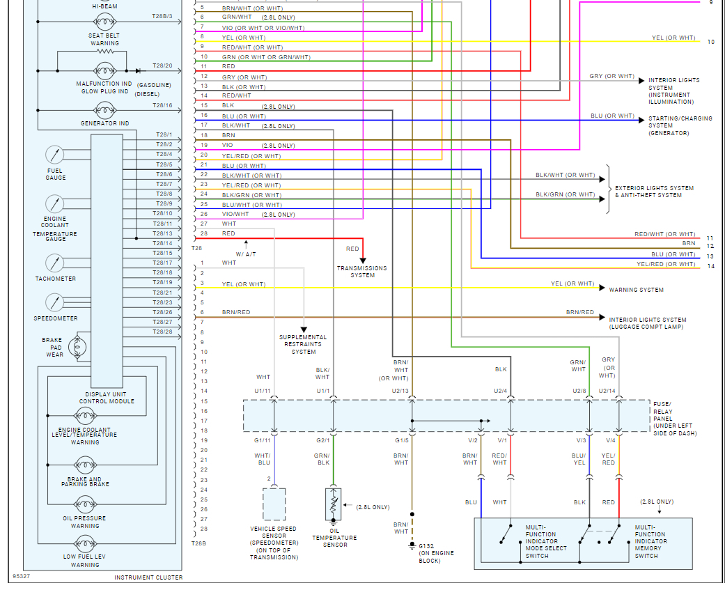

Sure, here are the instrument cluster pinouts and wiring diagrams for clarity, this guide can help you with the testing.
1- Outside air temperature sensor -G17-, Ground (GND) 1)
2- Engine Coolant Level (ECL) sensor -G32-
3- Terminal 31, Ground (GND)
4- Multi-function indicator memory switch -E109- (reset) 1)
5- Terminal 31, Ground (GND)
6- Multi-function indicator memory switch -E109- (memory) 1)
7- Vehicle Speed Sensor (VSS) output
8- Oil pressure switch -F1-, 1.8 bar
9- 0.3 bar oil pressure switch -F22-
10- Terminal 1/terminal W
11- Terminal 30, battery positive voltage (B+)
12- Terminal 58b, lighting
13- Terminal 15 (B+ with ignition switched on)
14- Open
15- Multi-function indicator mode select switch -E86-1
16- Generator (GEN) warning light -K2-, terminal 61
17- Engine oil temperature sensor -G8- 1)
18- Brake and parking brake warning light -K7-
19- Outside air temperature sensor -G17-, signal 1)
20- Malfunction Indicator Lamp (MIL) -K83-, or glow plug indicator light -K29- (Diesel)
21- Fuel gauge -G1-
22- Left turn signal indicator light -K65-
23- Engine Coolant Temperature (ECT) gauge -G3-
24- Right turn signal indicator light -K94-
25- Headlight high beam indicator light -K1-
26- Input signal, fuel consumption 1)
27- Vehicle speed signal from speedometer Vehicle Speed Sensor (VSS) -G22-
28- Transmission Range (TR) selector lever display (AG4)
1) Only with multi-function indicator -J119-

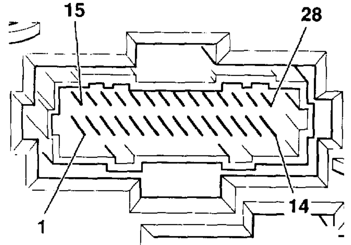

Check out the images (below). Let us know if you need anything else.

Thank you. Can you highlight which pin is the power, ground, speedometer and tachometer?
Apr 21, 2024 at 6:47 AM
  • 55,766 POSTS
Sure, there are two power pins one is switched while the other is constant battery.
26- Input signal, fuel consumption 1) TACH

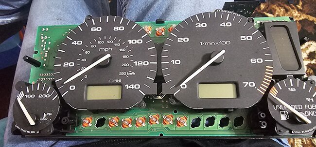

There are 2 plugs, one orange one black. They have the same pin count, but which one do I use?
Apr 22, 2024 at 11:10 AM
  • 55,766 POSTS
I would try either one to see if whatever you are doing will work.
Apr 23, 2024 at 3:04 AM
SCION
  • 41 POSTS
You forgot to mention pin 5 for ground, it's not only pin 3. Also, for anyone else in the future testing oma mkIII, its the black plug, not the orange. So, pin 3 for gnd, pin 5 for gnd, pin 11 to turn on cluster (the power box is not detecting thr cluster) and pin 13 to turn on lights (the power box now detects the cluster)
Jul 8, 2024 at 3:01 PM
SCION
  • 41 POSTS
It's also flashing the oil and temperature light, LOL.
