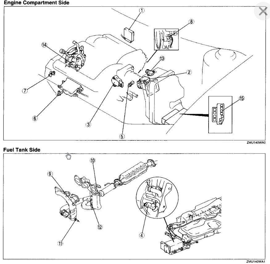

These are the codes I got from AutoZone:
P0174 System Too Lean (Bank 2)
P0051 HO2S Hester Control Circuit Low (Bank 2, Sensor 1)
P0300 Random Misfire Detected
Oct 17, 2019 at 5:45 AM
Okay, more than likely the o2 sensor is the issue. Before we get into testing these different systems, I would just swap the upstream o2 sensors from side to side. Once you swap them, clear the codes and drive it again and see if the codes switch to Bank 1. If they do then we need to replace the o2 sensor.
Clearly we can test them but this way is so much easier and definitive. Let me know if you have questions.

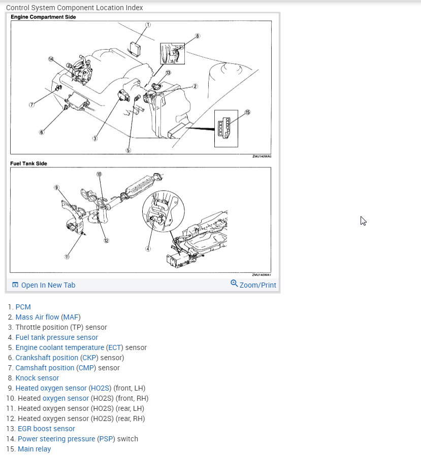

I got this done today:
Oct 17, 2019 at 11:19 PM
Okay, so if I understand this, you had three sensors replaced and then a few months later is when you started having this issue? Now you have an o2 sensor code for the bank 2 sensor 1 and you just replaced one of the downstream sensors?
If this is the case, then what you just replaced doesn't address the bank 2 sensor 1 (Upstream) sensor. I suspect that the sensor that you replaced back in April has gone bad. Basically you have a Bank 2 sensor 1 code that you need to address.
Let me know if I am missing something. Thanks
Oct 18, 2019 at 11:19 AM

No. These parts are going to be the same. It is the programming and in some cases there is an addition of an air pump or other components to help with emissions. However, the o2 sensors will be the same.
I would suggest trying to call who replaced the o2 sensors and find out if this one was replaced. I assume it was and if so, then either you either have an issue in the wiring of that sensor or possibly the control module. However, I suspect the sensor just failed. Unfortunately, these replacement parts are not of the best quality so it is not surprising when one fails.
