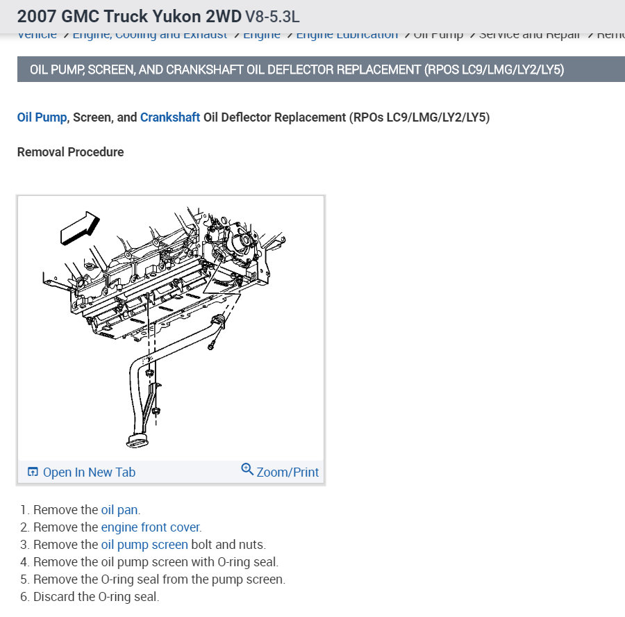

I have a 2007 GMC Yukon XL. It has 90,000 miles on it. Oil pressure started going down and the engine made a ticking noise. Soon I had more problems and the mechanic found one of the valve springs broken. The engine started emitting blue smoke and the engine rattles. A computer diagnosis showed # 6 plug not firing. The plug was covered with oil. I changed the valve seals, piston rings, etc but the diagnosis kept showing low oil pressure should I change the oil pump?
Sep 14, 2009 at 6:32 PM
BRIAN 1
  • 1,030 POSTS

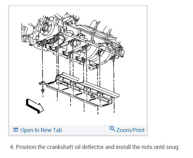

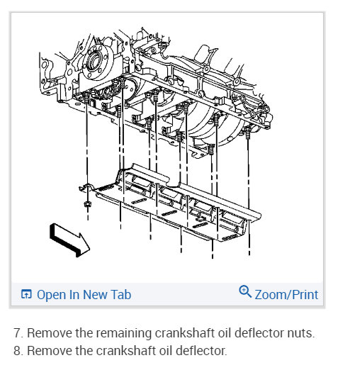

I would look at the oil pump pick up screen because they can clog due to lack of maintenance. If that's okay do the oil pump here are the instructions to do so in the diagrams below. Check out the diagrams (Below). Please let us know what you find. We are interested to see what it is.

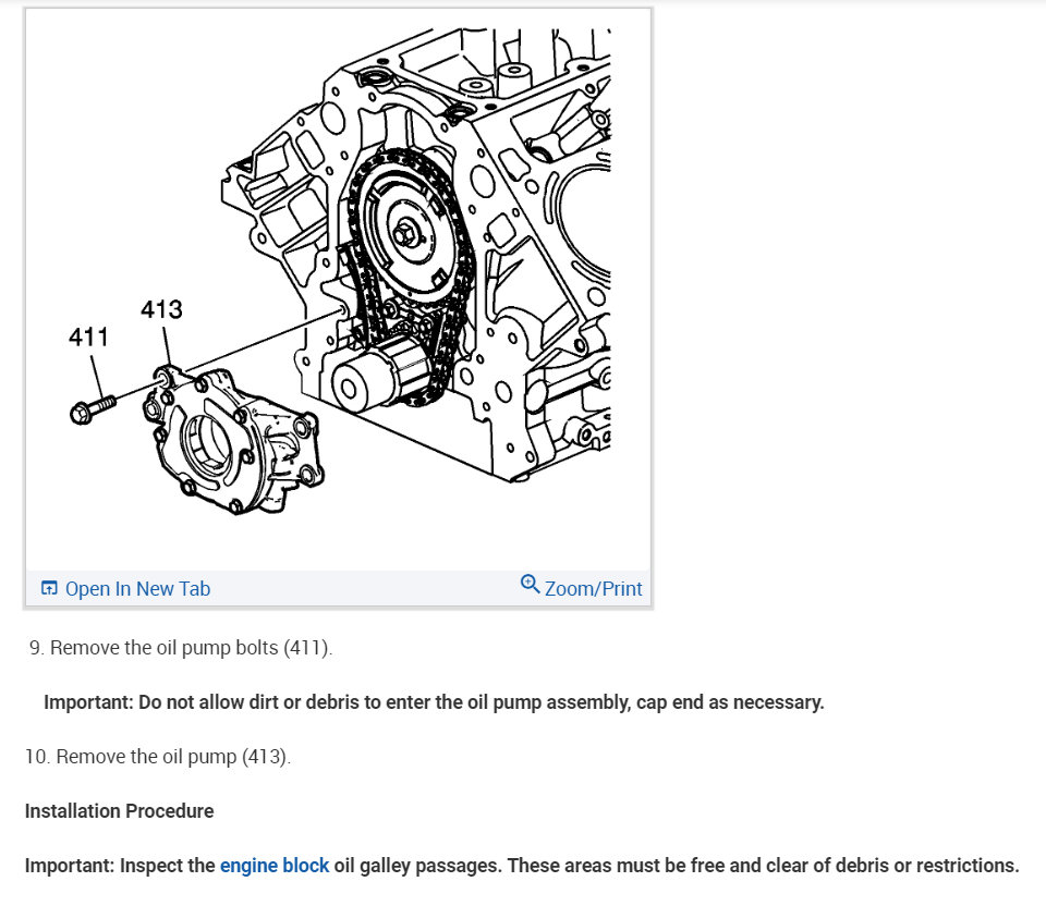

how much time to replace oil pump on 2005 yukon denali 60. awd
Apr 25, 2020 at 6:46 PM (Merged)
RIVERMIKERAT
  • 6,110 POSTS
Couple of hours. Need to support front of engine with a jack, remove engine mounts,lift engine, and drain and remove oil pan.

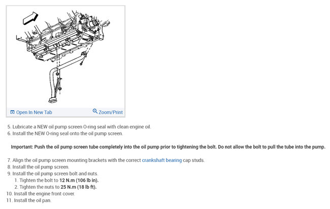

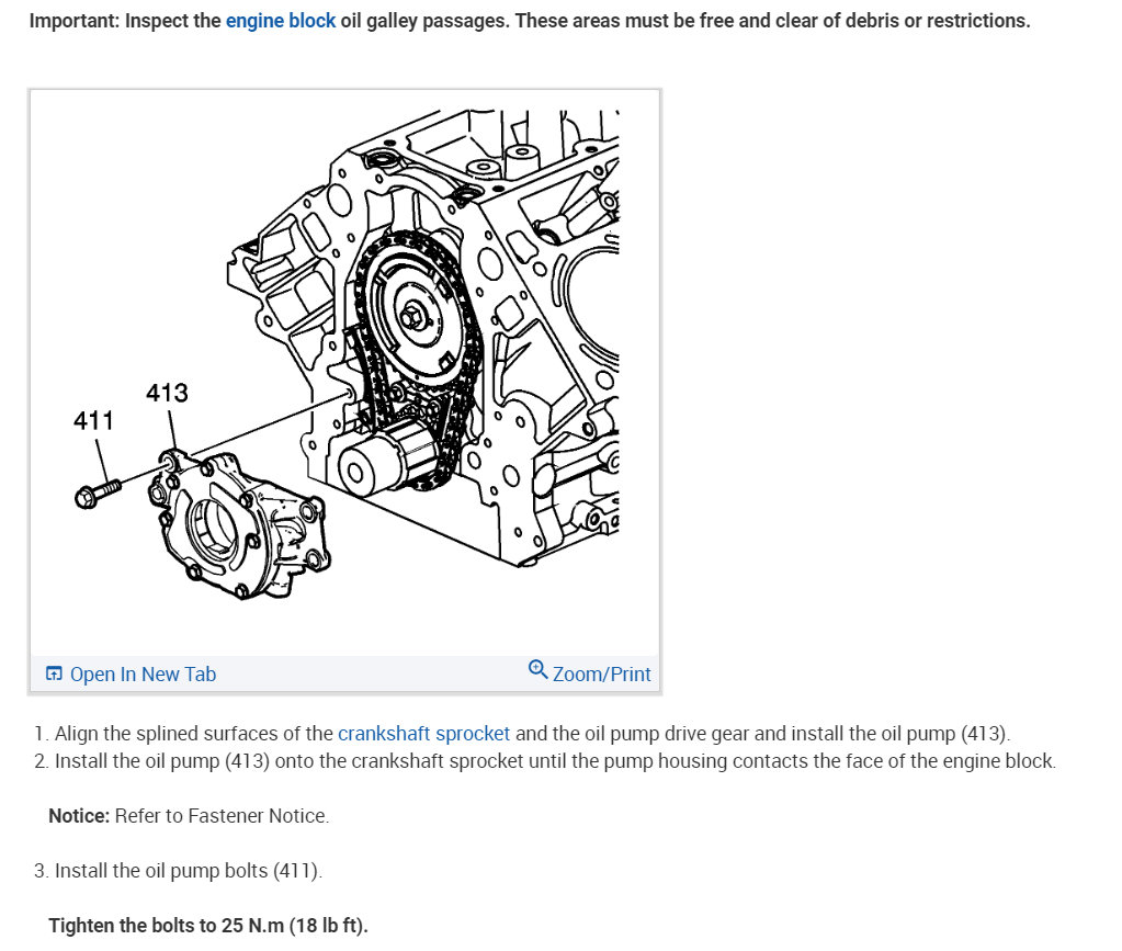

so i removed the oil pump and i replaced it with a new one. I just wanted to know what is the torque for the bolts to tighten it.?
HMAC300
  • 48,601 POSTS
what engine? if it's a 4.8_6.0L make sure to seat oil pickup into pump prior to tightening bolt-106 in. lb. the 4 bolts that hold pump on tighten to 25NM or 18 ft.lobs.
