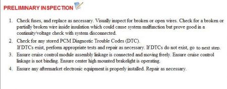

Follow the troubleshooting steps below. If no problem is found let me know so I can give further troubleshooting procedures...
https://images.2carpros.com/forum/automotive_pictures/261618_Noname_1384.jpg
