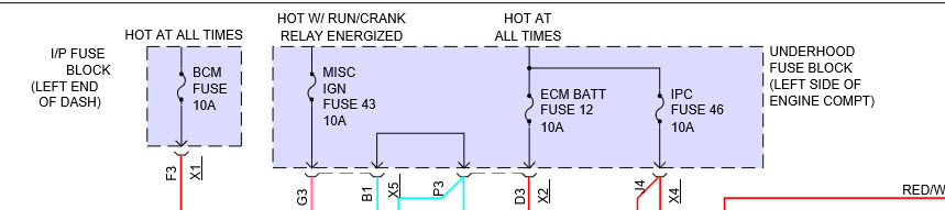

The lights on the steering wheel still come on for the cruise control but it will not work. What would cause this to happen and how do we fix it.

check fuses in picture then if they are all good, use a test light on them. then have a mechanic scan for codes as it may be a body module problem.
Image (Click to enlarge)
