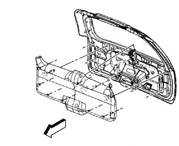

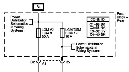

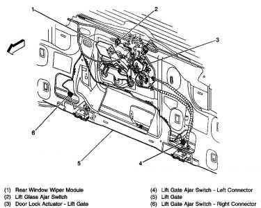

Just out of no where the rear hatch will not work what so ever. I cant get the lock to unlock with the wireless key and it has no entry for a key on the hatch. The glass also will not open or even make a sound...Now all of the other doors and windows on the other 4 doors work fine no problems what so ever..It sounds like a short to me but this suv is so new and well taking care of.... im leaning to maybe a faulty relay..the one box in the interior but no luck for door locks..any help would be great.
Service writer, the ECC 10 amp fuse appears ok, would there be another fuse I could try. He Yukon is out of warranty.

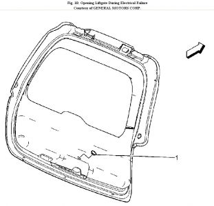

You can check these. Swap them out with another fuse of the same to be sure. Same goes for the ECC. You may need to manually open the liftgate to get at the components inside the door to check for wiring problems or bad connections. Check any harnesses that are bent on a tighter radius that will flex when the gate goes up and down.

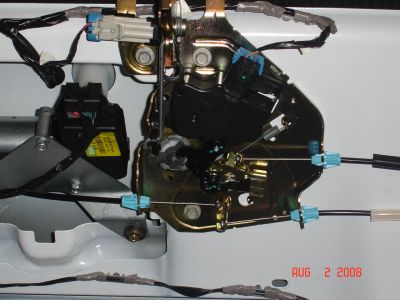

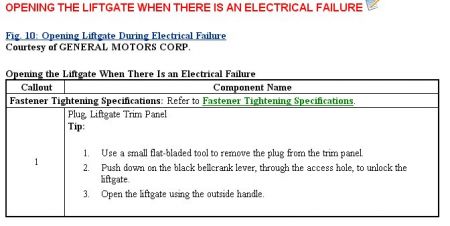

Service Writer, I believe we are getting close, but no cigar just yet. The 06 Yukon does not conform to the Fig.10 diagram ( opening liftgate during electrical panel)....It does have a pull down strap that the owner can use when closing the hatch. This strap uses a small hex head type screw. Upon removing this strap it makes it easier to pop out the bottom panel and expose all of the workings. Once you manual unlock the level you can utilize the push button for the glass or the level for the hatch. I sprayed the workings with WD-40 and noticed while using the remote lock the mechanism appears to wiggle. This tells me that it is not fuse related but more of a failure of the lock/unlock mechanism. Should I continue to track down electrical/fuse or does it also seem it is the lock/unlock mechanism?. I may try to decipher uploading a picture if this will help. Thank you again, we are close. Handshake

here is the picture of the mechanism......

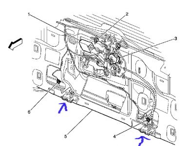

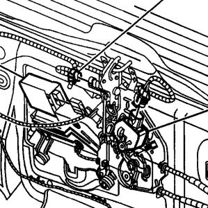

Does this look like what you have?
https://images.2carpros.com/forum/automotive_pictures/30961_lift_1.jpg

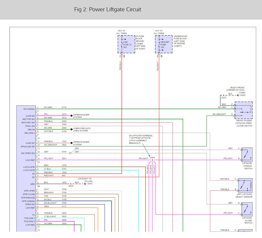

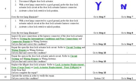

IF there is no noise at the actuator, then this is still electrical, other wise you would hear or see a reaction when the button is pressed. Test for power at the arrows, I expect none. This is the flow chart:
https://images.2carpros.com/forum/automotive_pictures/30961_lift1_1.jpg
Check for power going into the actuator harness, IF present, I would expect the actuator to be bad.

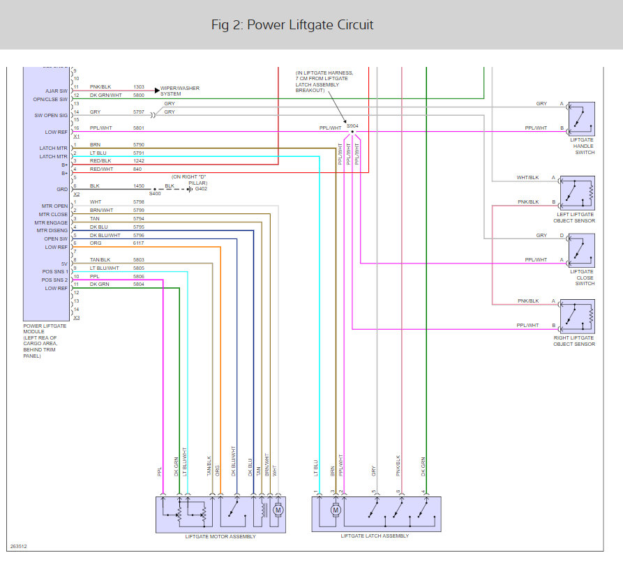

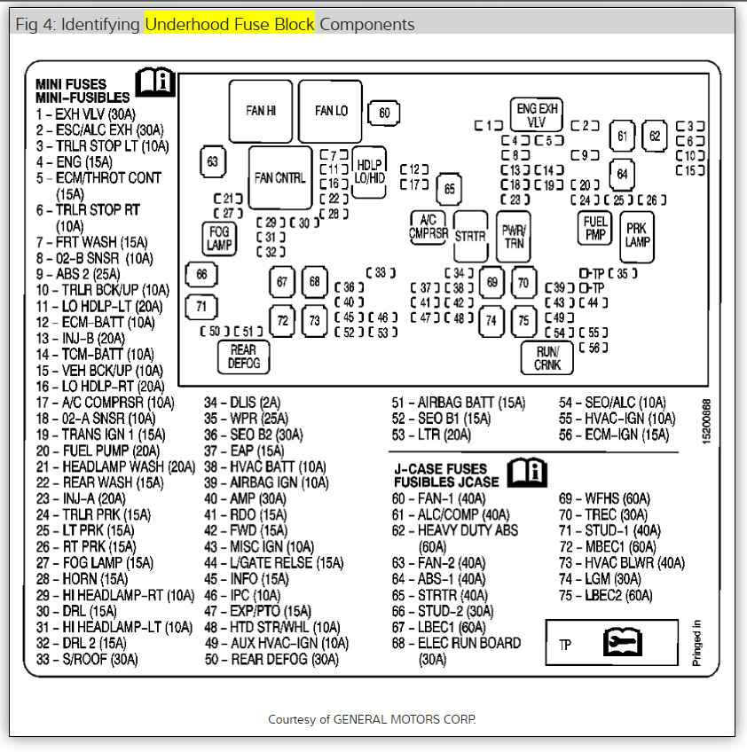

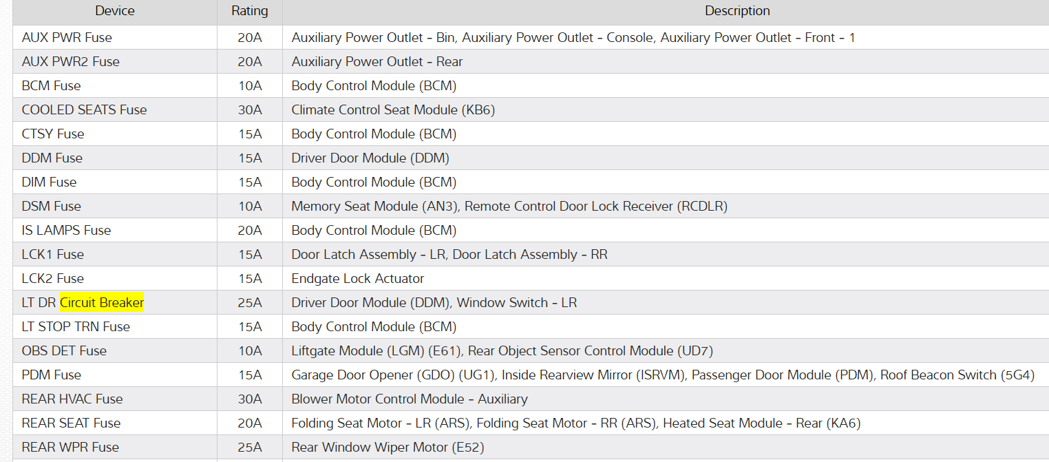

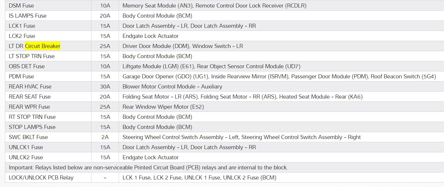

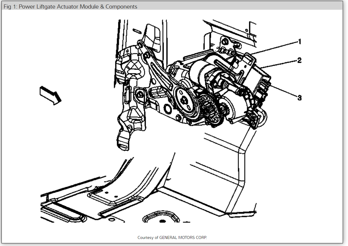

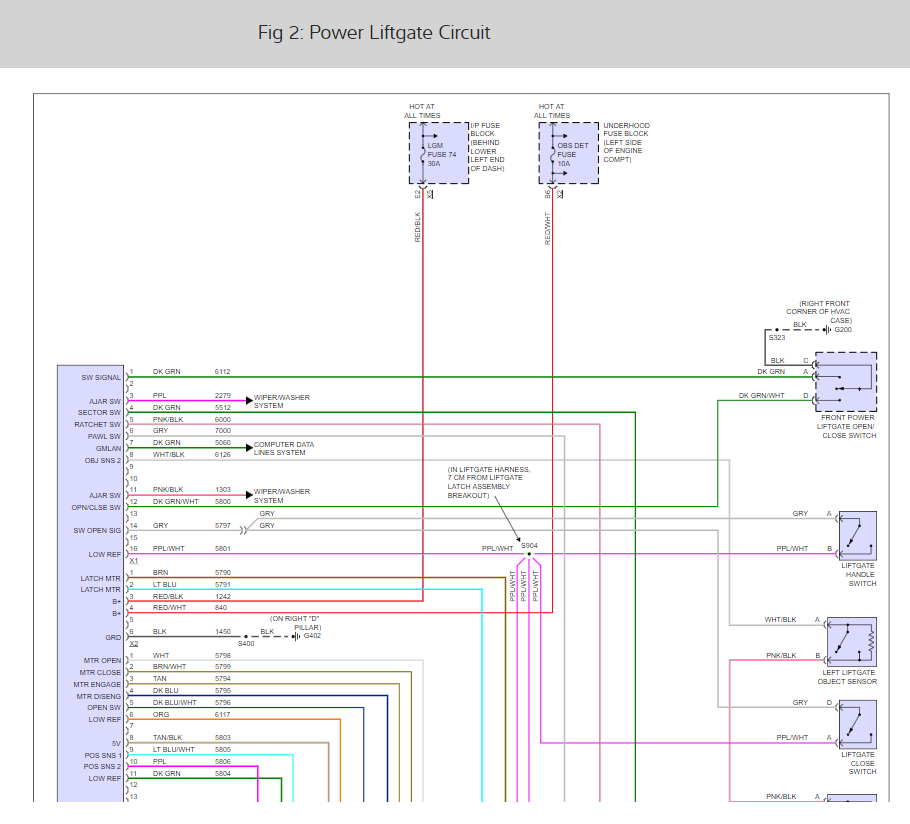

It sounds like you have a lift gate power module that is going out but lets check the fuses first there are two. One is under the dash and the other under the hood. Here is a guide to help you and the fuse location with the wiring diagrams for the lift gate so you can see how the system works:
I would check the module electrical connector for corrosion here is the location of the module as well.
Check out the diagrams (below). Please let us know what you find.

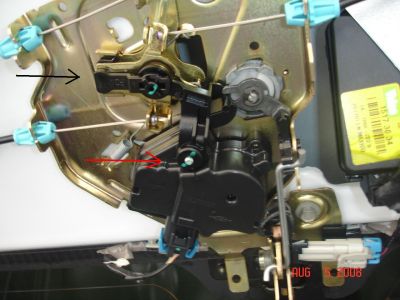

HANDSHAKE
  • 13 POSTS
https://images.2carpros.com/forum/automotive_pictures/212630_DSC01195_1.jpg
The black arrow is able to be moved to lock or unlock the mechanism...the red arrow does not rotate when the button is pressed to lock or unlock...it does wiggle when the lock/unlock button is pressed.

2CARPRO JACK
  • 11,533 POSTS
The two cables above the actuator, try moving them to se if the latches will release. Sounds like the lock actuator may be bad or the latch assembly (motor)

HANDSHAKE
  • 13 POSTS
The black arrow is able to be moved to lock or unlock the mechanism...the red arrow does not rotate when the button is pressed to lock or unlock...it does wiggle when the lock/unlock button is pressed.[/quote:3eea8c8c94] pulling the cables doesn't help. It appears that the lock actuator and motor are one piece. If this is so, then I might try replacing this assembly. Like I mention when you press the lock/unlock the lock actuator wiggles but does not engage.

2CARPRO JACK
  • 11,533 POSTS
I understand that. Unhook the cables, i want to be sure that the latches arent keeping the motor from working

HANDSHAKE
  • 13 POSTS
[quote:261051a9a9="2CarPro Jack"]I understand that. Unhook the cables, i want to be sure that the latches arent keeping the motor from working[/quote:261051a9a9]
Done....nothing!...Its like the motor wants to turn the mechanism but won't. Sounds like we are getting close...

2CARPRO JACK
  • 11,533 POSTS
Sounds like abad motor, just be sure that it is getting a full 12 volts

Your subject description is right, actuator
https://images.2carpros.com/forum/automotive_pictures/30961_ta_1.jpg
https://images.2carpros.com/forum/automotive_pictures/30961_tat_1.jpg
Although I haven't done one, the mitchell manual does give a step by step instruction.

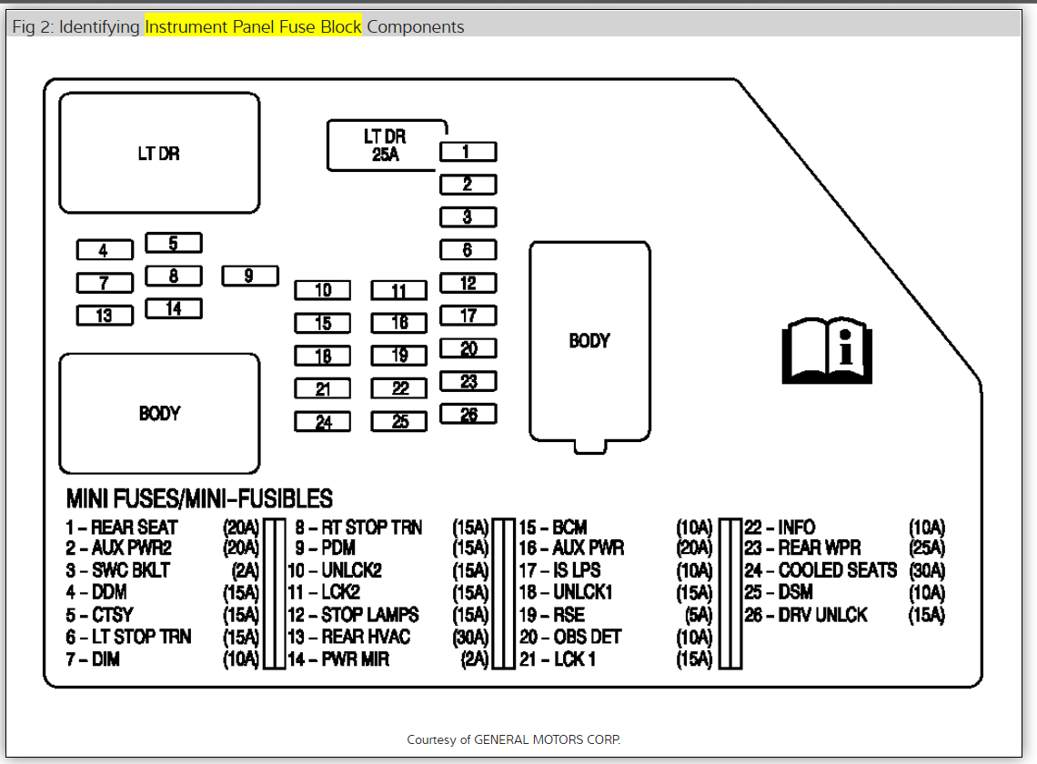

MRSSARAH RELLY RELL
A few weeks ago my charger broke and a small metal piece fell into my lighter port causing some fuses to blow. I checked and changed the one for the lighter, now I cannot locate where the fuse is for my rear hatch or four wheel drive. My husband is in prison and I need Hungary working before the snow comes. please help
Feb 3, 2021 at 8:07 AM (Merged)

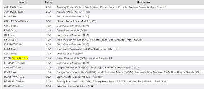

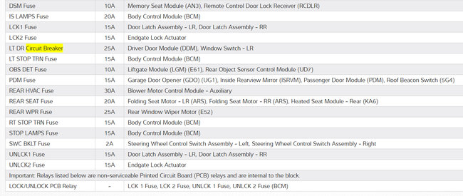

HMAC300
  • 48,601 POSTS
rear glass is fuse 13 in dash fuse box. if fuse is good it may be a bad switch or wiring issue. four wheel drive fuse is 24 and 14 in dash fuse box.
