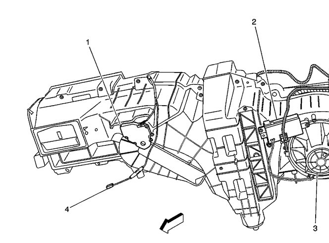

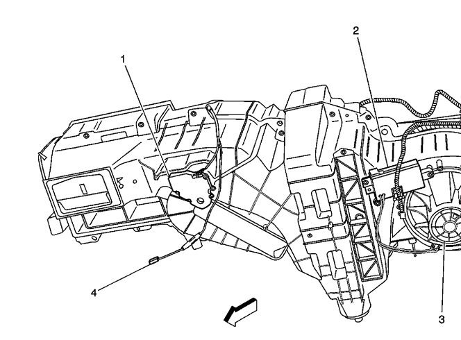

check your actuators to see if they are getting power and working generic pic below and a guide to help walk you through the repair.
