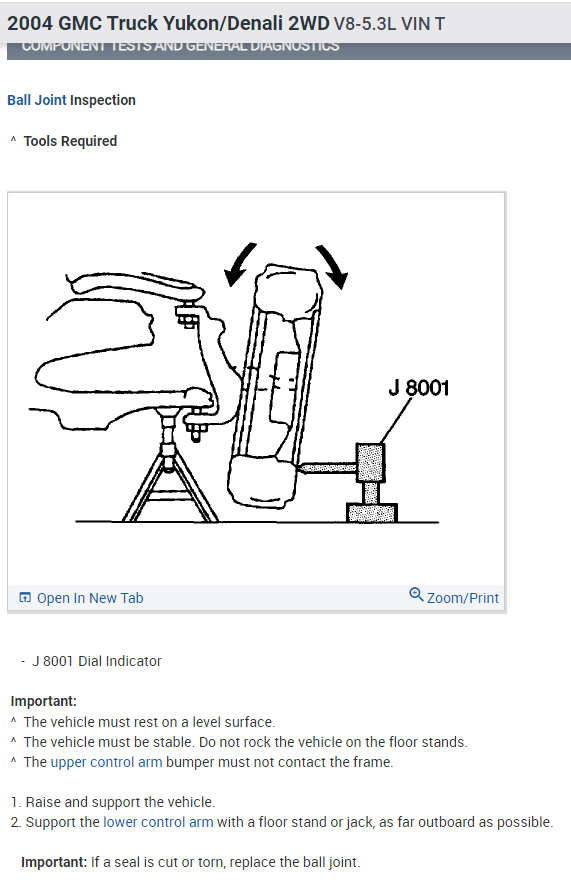

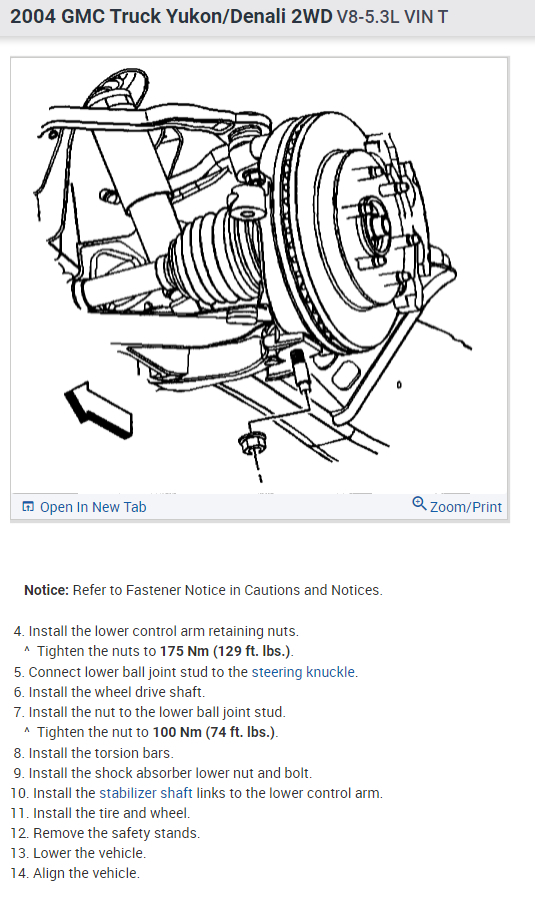

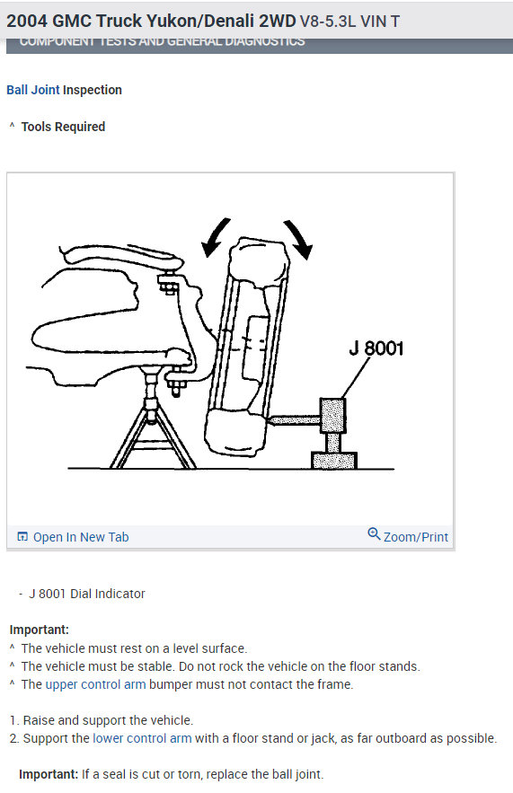

my truck starts shaking really bad when i hit the brakes on the highway. what do i need to do?
Nov 18, 2008 at 10:57 PM
SQM
  • 6,383 POSTS
Just to clarify, it only shakes when you apply the brake at highway speed, and no other time?

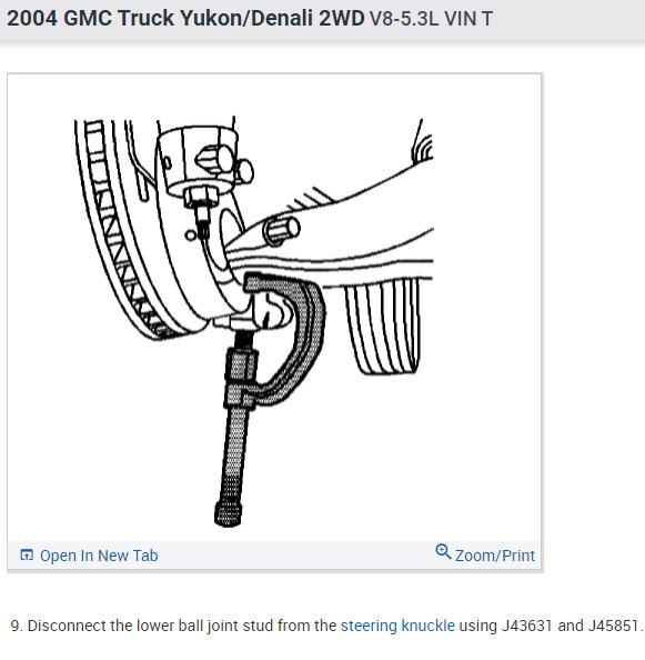

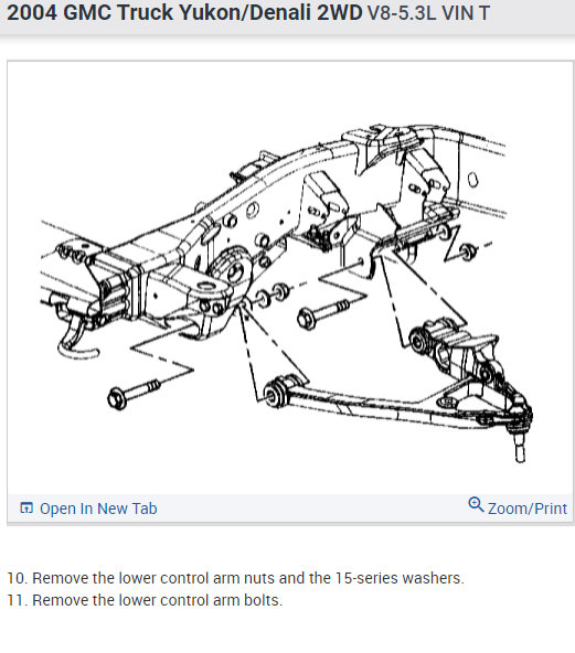

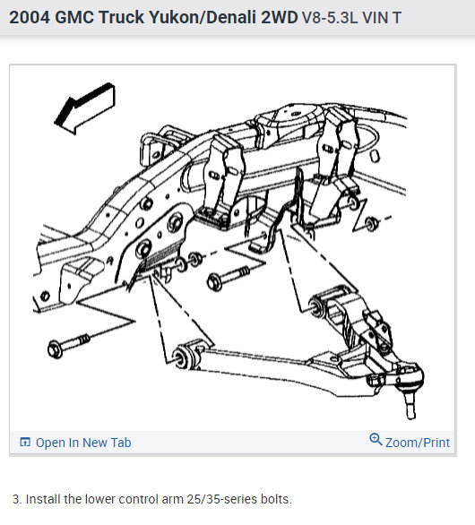

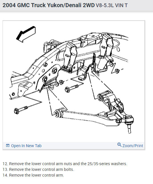

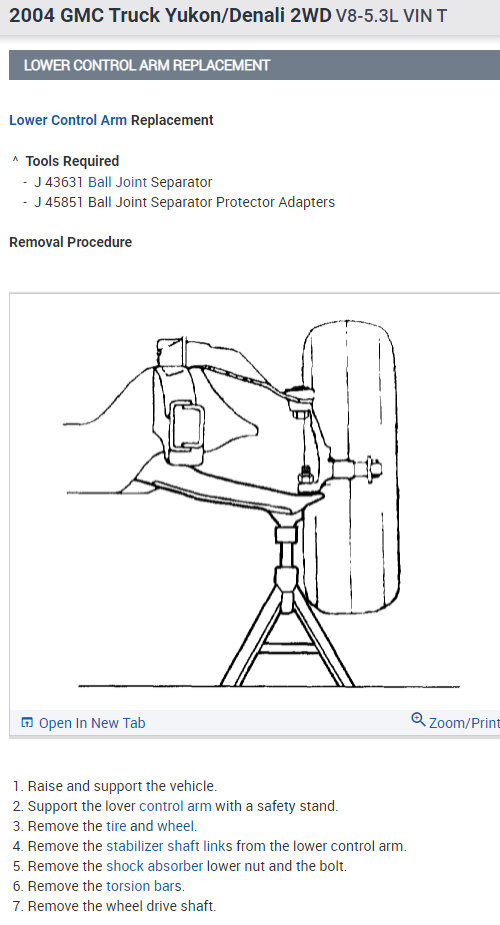

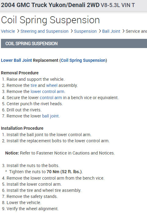

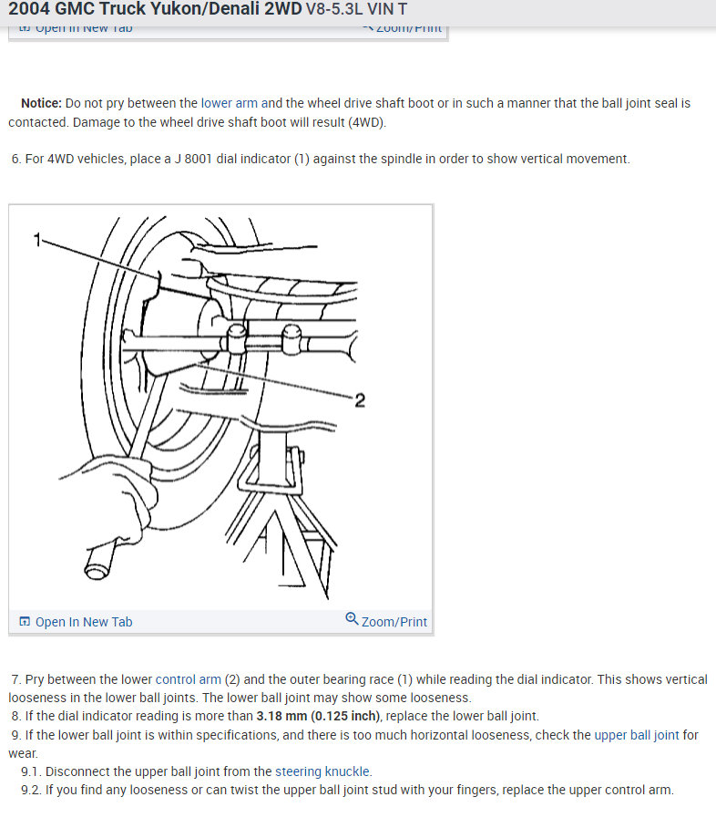

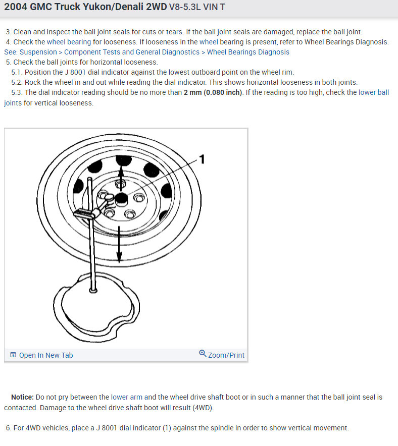

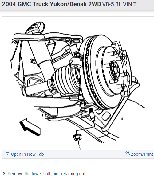

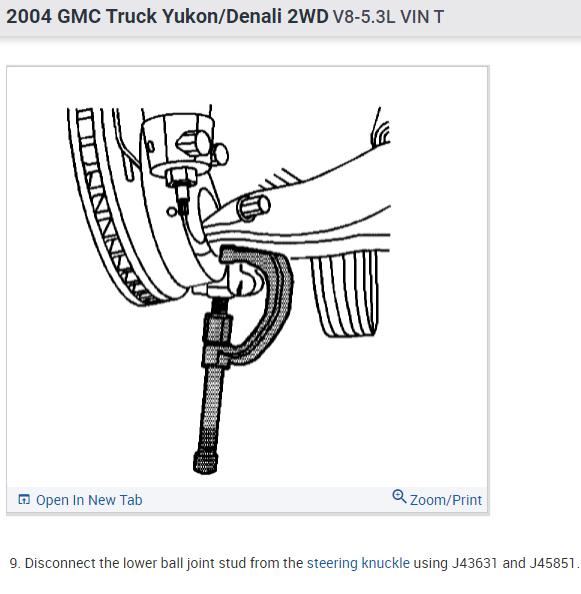

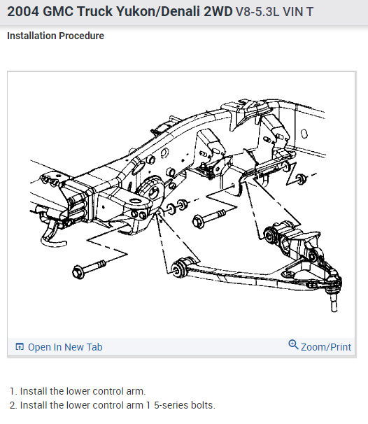

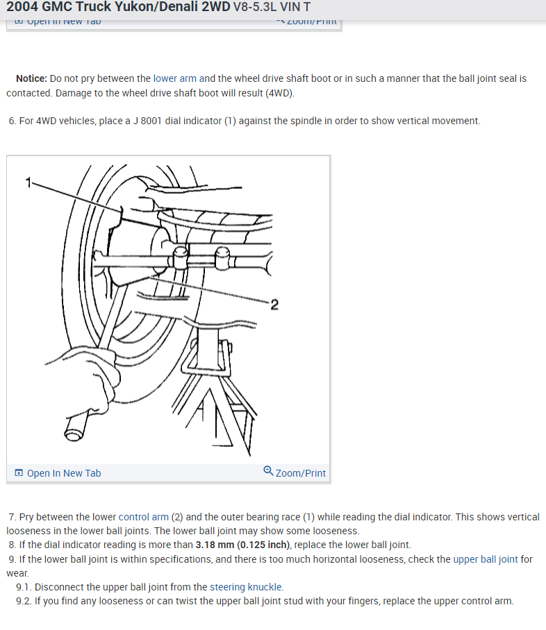

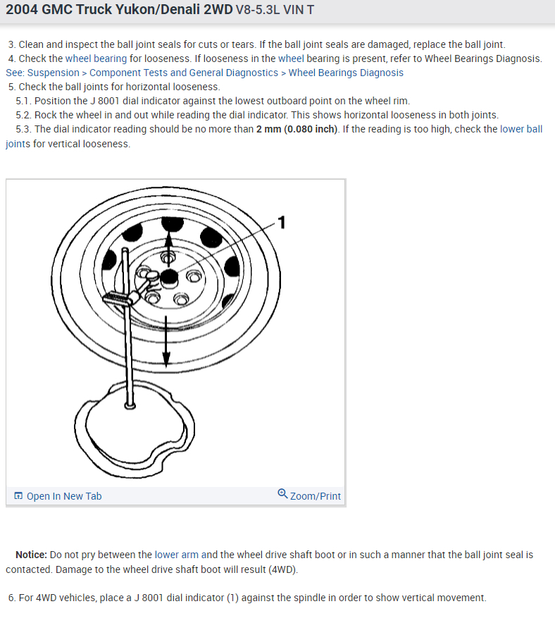

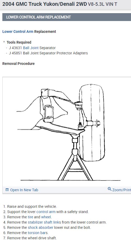

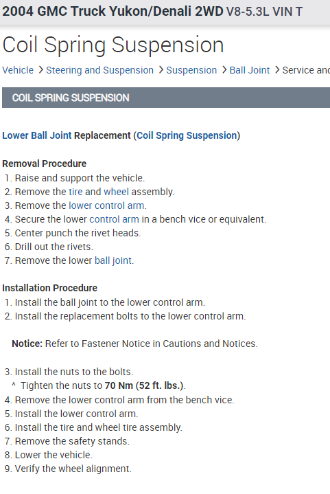

You could have a worn lower ball joint or lower control arm bushing.
https://www.2carpros.com/articles/how-to-release-a-ball-joint
https://www.2carpros.com/articles/lower-control-arm-bushing-replacement
It could also do that if you have a out of balance tires.
I have attached the control arm and ball joint replacement procedure for your reference. Also included on how to check for worn out ball joints and control arms.
