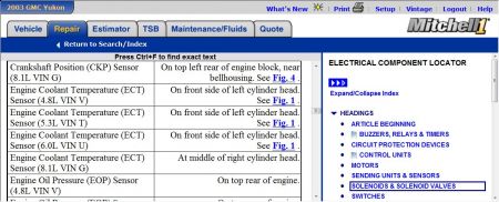

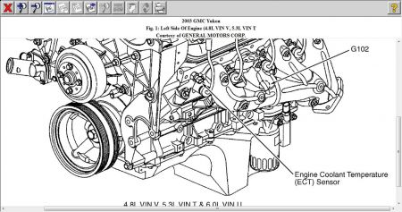

I cannot find the location of my coolant temperature sensor to replace it. Any help is greatly appreciated!
Dec 15, 2009 at 6:56 AM
  • 75,992 POSTS
See below

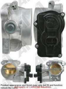

does anyone have a diagram on where the throttle body is located? thanks in advance!
Jan 20, 2010 at 10:41 AM
  • 75,992 POSTS
This is your throttle body assy
