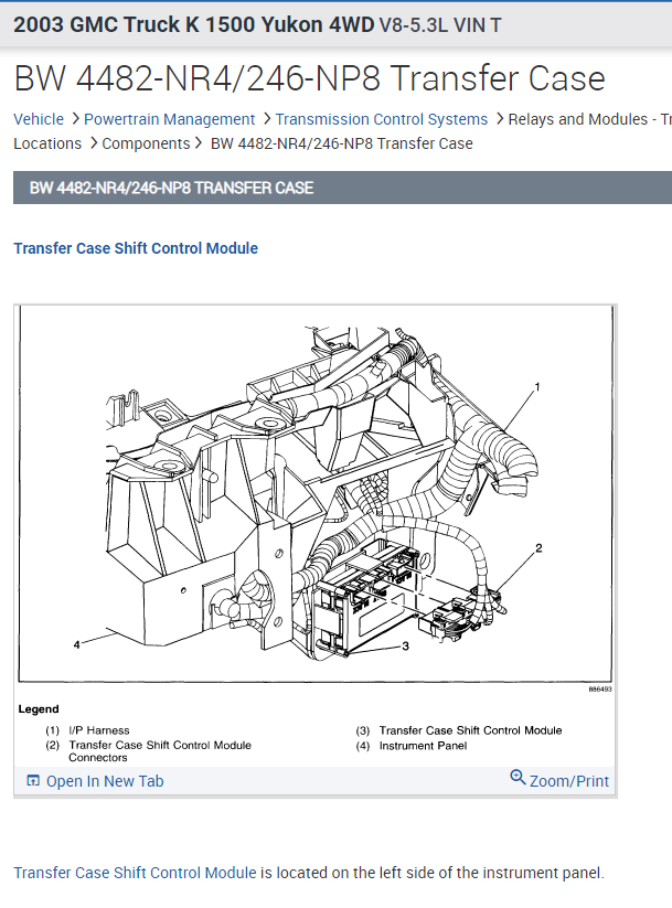

If you did not change the throttle input then it sounds like the transmission is downshifting.

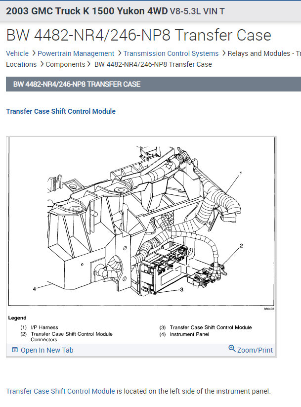

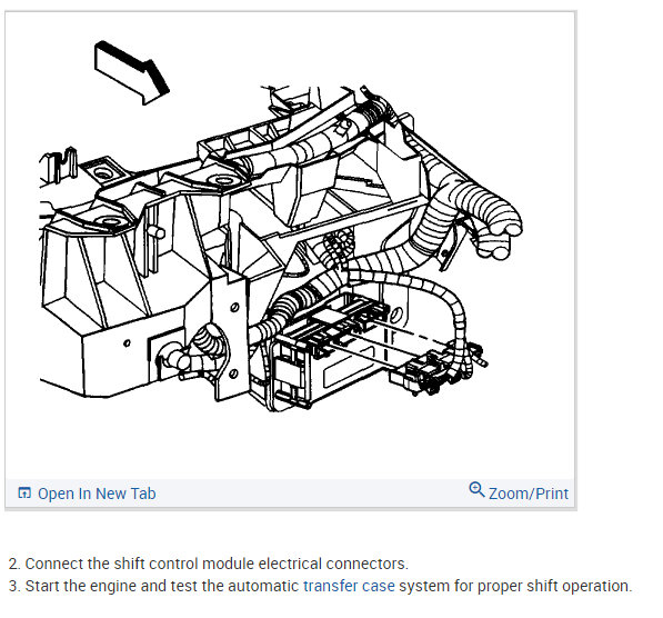

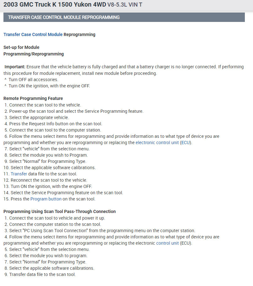

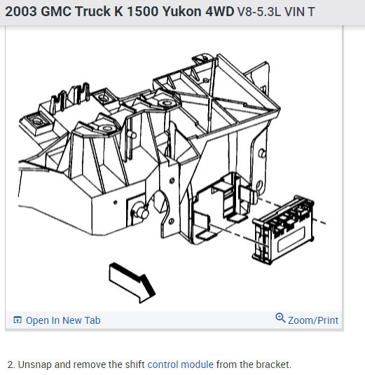

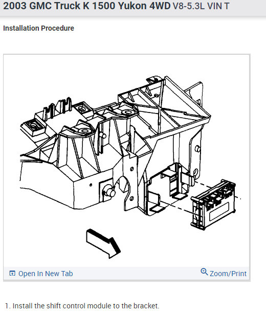

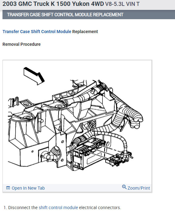

If it does that without any input on your behalf, it can be due to transfer case control module. It can be due to the transfer case 'thinking' you need to be on four wheel low and triggering that.
Transfer Case Shift Control Module is located on the left side of the instrument panel.

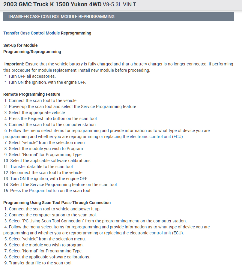

I have included the reprograming and replacement procedure for that module (look below).
