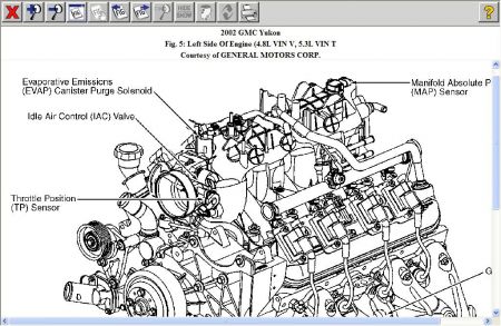

My Yukon is throwing code P0446 which I have been told can be the purge canister or the solenoid. My question is where is the evap canister purge solenoid located? Do I need to drop the tank to replace it?

Purge solenoid for 4.8L/ 5.3L /6.0L engines
https://images.2carpros.com/forum/automotive_pictures/12900_purge_1.jpg
The canister-follow the evap lines from the fuel tank towards the front you'll run right into it.
