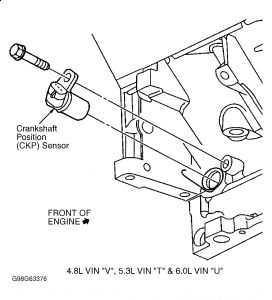

** please provide location of Crank position sensor. Thanks...

Crankshaft Position (CKP) Sensor (5.3L VIN T)located On lower right rear of engine block
https://images.2carpros.com/forum/automotive_pictures/99387_Graphic1_673.jpg
