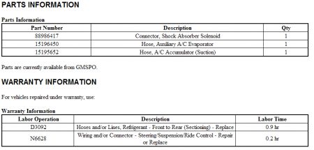

There is a tech bulliten on your suspension, but it needs to be scanned for C codes if the code in the TSB pops, you have the info! Service Ride Control Message Displayed, DTC C0580 Set (Replace Right Front Shock Absorber Solenoid Connector and Install New A/C Suction Hose and Auxiliary A/C Evaporator Hose) TECHNICAL SERVICE BULLETIN Reference Number(s): 03-03-11-001,  Date of Issue:   July 22, 2003 Related Ref Number(s): 03-03-11-001 ARTICLE BEGINNING CONDITION Some customers may comment on the Service Ride Control message being displayed. Upon investigation, the technician may find DTC C0580 set. CAUSE Poor clearance between the auxiliary A/C evaporator hose and the right front shock absorber damper solenoid connector may be the cause of this condition. Contact may occur damaging the connector and causing a poor connection at the damper solenoid. CORRECTION Replace the right front shock absorber solenoid connector and install a new A/C suction hose and auxiliary A/C evaporator hose. These new A/C hoses will provide proper routing to prevent contact between the auxiliary A/C evaporator hose and the right front shock absorber damper solenoid connector. Use the procedure listed below. 1. Recover the refrigerant. Refer to Refrigerant Recovery and Recharging in the HVAC sub- section of the Service Manual. 2. Raise the vehicle. Refer to Lifting and Jacking the Vehicle in the General Information sub- section of the Service Manual. 3. Remove the right front wheel assembly. 4. Remove the right front wheelhouse panel. 5. Remove the nut and the auxiliary evaporator hose from the accumulator line block. 6. Remove the nut and the suction hose from the accumulator. 7. Remove the bolt and the suction hose from the compressor. 8. Install the new suction hose and bolt to the compressor. Tighten: Tighten the bolt to 16 N.m (12 lb ft). 9. Install the new suction hose and nut to the accumulator. Affected Model(s): 2002-2003 Cadillac Escalade; 2003 Cadillac Escalade ESV; 2001-2003 Chevrolet Suburban, Tahoe; 2001-2003 GMC Yukon, Yukon XL; with Rear Air Conditioning System (RPO C69) and Real Time Damping Chassis Package (RPO Z55) Page 1 of 3 Service Ride Control Message Displayed, DTC C0580 Set (Replace Right Front Shock A...Tighten: Tighten the nut to 16 N.m (12 lb ft). 10. Release 4 line retaining clamps, starting at the wheelhouse and along the underbody towards the rear of vehicle. Fig. 1: Auxiliary Evaporator Line Courtesy of GENERAL MOTORS CORP. 11. From under the vehicle, mark the location on the auxiliary evaporator line where the line will be cut. Using the forward running board bracket as a reference, mark the location inline with the bracket-to-body bolt (1). If the vehicle is not equipped with running boards, mark the location inline with the bolt hole. 12. Using a tubing cutter, cut the marked section of the auxiliary evaporator line. 13. Remove the front section of the auxiliary evaporator hose from the vehicle and discard. 14. Install the new front section of the auxiliary evaporator hose into the vehicle. 15. On both sections of the auxiliary evaporator line, cut back the plastic coating approximately 76 mm (3 in). 16. Splice in the new front section of the auxiliary evaporator hose using J 41425 A/C Line Repair Kit and J 41425-750 splice. Refer to the Heater and A/C Pipe Repair - Auxiliary procedure in the Service Manual. 17. Install the auxiliary evaporator hose to the accumulator line block and nut. Tighten: Tighten the nut to 16 N.m (12 lb ft). 18. Secure the line retaining clamps. 19. Install the wheelhouse panel. 20. Install the wheel assembly. 21. Lower the vehicle. 22. Inject the oil into the A/C system that was removed during the recovery process using J 45037 A/C Oil Injection Kit. 23. Evacuate and recharge the refrigerant. Refer to Refrigerant Recovery and Recharging in the HVAC sub-section of the Service Manual. 24. Leak test the fitting and splice using J 39400-A Halogen Leak Detector. 25. Replace the right front shock absorber solenoid connector using service connector, P/N 88986417. Refer to Wiring Repairs in the Wiring Systems sub-section of the Service Manual. Page 2 of 3 Service Ride Control Message Displayed, DTC C0580 Set (Replace Right Front Shock A...

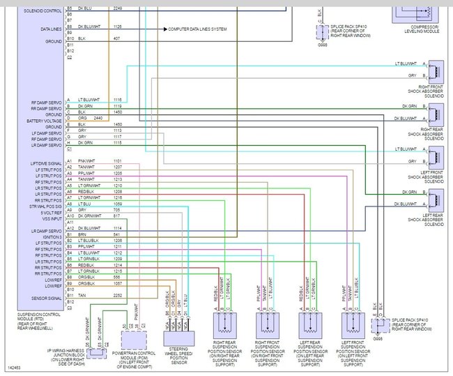

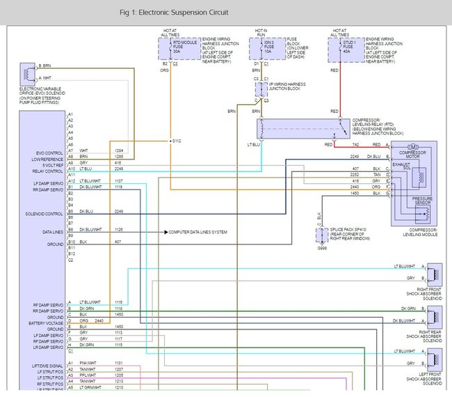

There is a compression relay that sounds like it went out, but please check all fuses as well, here are two guide and a wiring diagram (below) that will help you.
and
Please run some tests and get back to us so we can continue helping you.
Best, Ken

need to see if you have available a wiring diagram for the air / ride control system. the compressor is not kicking on at all and I want to check it for a good power source and ground, and I see multiple level sensors that I want to test as well,.
