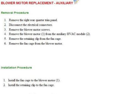

How does one remove the panels in order to access thr rear blower motor on a 2000 yukon?

https://images.2carpros.com/forum/automotive_pictures/261618_Noname_372.jpg
https://images.2carpros.com/forum/automotive_pictures/261618_Noname2_136.jpg
