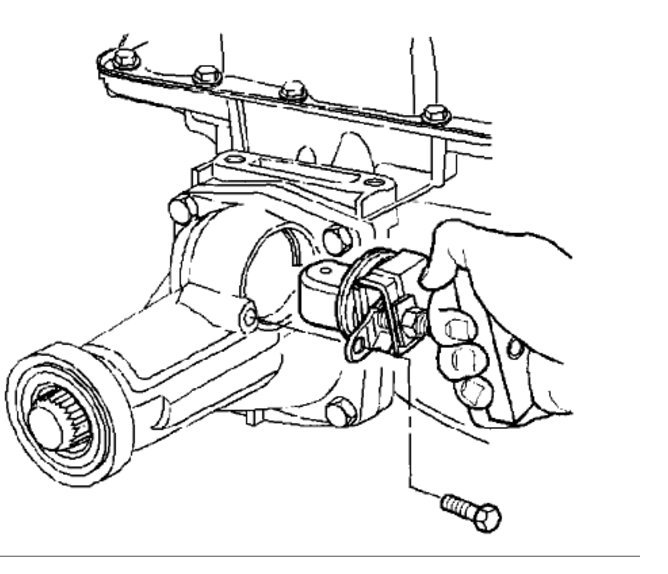

It sounds like the vehicle speed sensor has gone out and needs replacing. You will need to Here are some diagrams and a guide to help you got the job done.
Its held on by 1-13mm bolt and a little transmission fluid will come out as well.

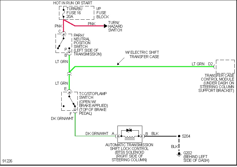

Changed the breaks in the front of the vehicle and ever since I did that the shifting lever will not move.
Jun 6, 2017 at 11:33 AM (Merged)
JDL
  • 16,098 POSTS
What about shift interlock mechanism? Any abs codes, any trouble codes for anything? Can you take the shift linkage loose from tranny and shift tranny by hand? If you try anything like that, engine off, level ground, tranny out of gear, functional e-brake is set, block the wheels. Have a helper sitting in cab with foot on the brake. Be safe.
GRANDAM96
  • 12 POSTS
Thank you for the response. Yes, it will shift by hand. Also, replaced the brake booster, master cylinder and brake switch.It was parked on an incline too.
GRANDAM96
  • 12 POSTS
I forgot to let you know that no codes are coming up. The brakes sound like their is air in them though.
JDL
  • 16,098 POSTS
You can't shift it without stepping on the brake. Below is wiring for shift interlock mechanism. A generic obd2 code reader may not read ABS codes?

JDL
  • 16,098 POSTS
When I hear speedometer and shifting issues, I think about the vehicle speed sensor? I can't guarantee anything. Check for applicable trouble codes. Some of the national brand auto stores will check codes for free. If you want to check codes, yourself, at the least, you need an obd2 code reader.
JDL
  • 16,098 POSTS
Check for voltage on the wiring circuits in the diagram, go from there.

JDL
  • 16,098 POSTS
You can click on the diagram to enlarge, note the wiring colors. If you can't print it, hand draw it.

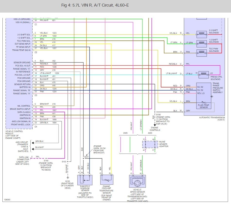

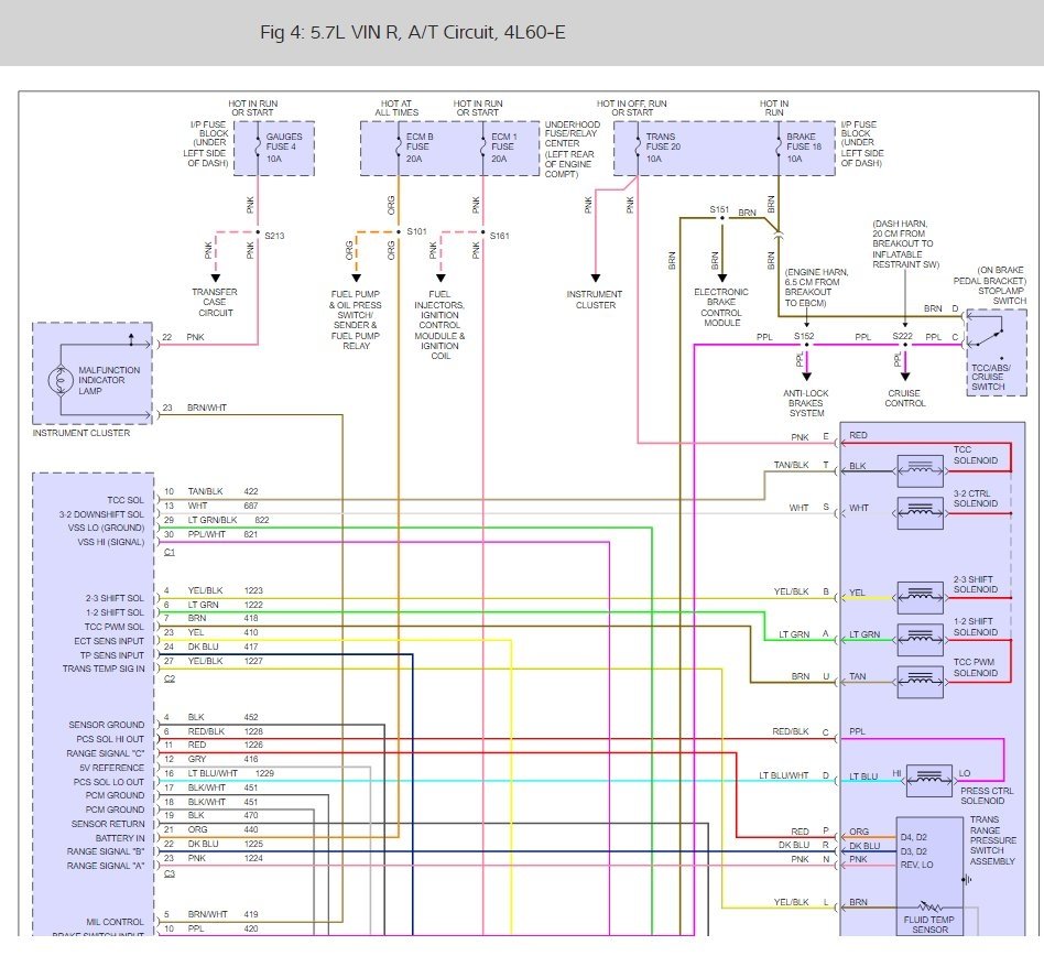

How many shift silenoid are they in there
Jun 6, 2017 at 11:34 AM (Merged)
  • 54,840 POSTS
Here is a wiring diagram so you can see all of the solenoids and be able to test them.
Please run some tests and get back to us so we can continue helping you.
