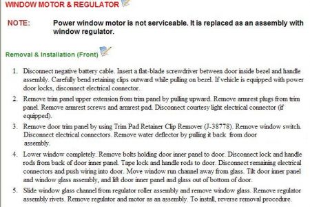

We are trying to replace the drivers side window motor. we can't get it off of the gear. And tricks?

https://images.2carpros.com/forum/automotive_pictures/261618_Noname_1181.jpg
