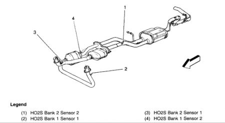

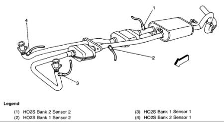

I had a fault code for a faulty O2 sensor, Bank 2 but didn't verify loc. Where are the two sensors in bank 2? I found one behind the catalytic converter an changed it out, then the fault code came up again. Where are the other bank 2 locations?
Aug 16, 2010 at 3:32 PM
  • 75,992 POSTS
Heated Oxygen Sensor (HO2S) Heavy Duty
https://images.2carpros.com/forum/automotive_pictures/12900_o_7.jpg
Heated Oxygen Sensor (HO2S) Light Duty
https://images.2carpros.com/forum/automotive_pictures/12900_o1_6.jpg
In the right exhaust pipe, after the catalytic converter https://www.2carpros.com/kpages/auto_repair_manuals_alldata.htm
