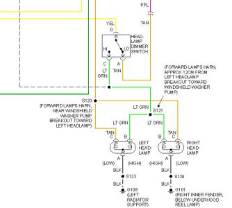

Does anyoine know where to locate the Day Time Running Light Module. I have not found it but it could be the problem with the no headlight issue I have been dealing with.

Left side of dash, taped to panel wiring harness.

Thank you for your help. I did find it, the module was inside of a black plastic box hanging from some wiring harness. However, that was not the problem. I may have to try the high beam switch next.

Sounds like the next most loical spot to test.

Thanks for all of your help, I finally had to change out the Signal switch wand that did solve the problem. I know three other Tahoe or Yukon owners that had to do the same thing over the past three months. These must be a problem in general. Thanks GM.
Anyway I got mine at a junk yard but of course its a gamble, since you moght be getting another problem, however, I got mine for free and swapped the broken flasher button out with my original one that worked fine. All things are good once again.
Thank you to everyone that helped me with advise.
