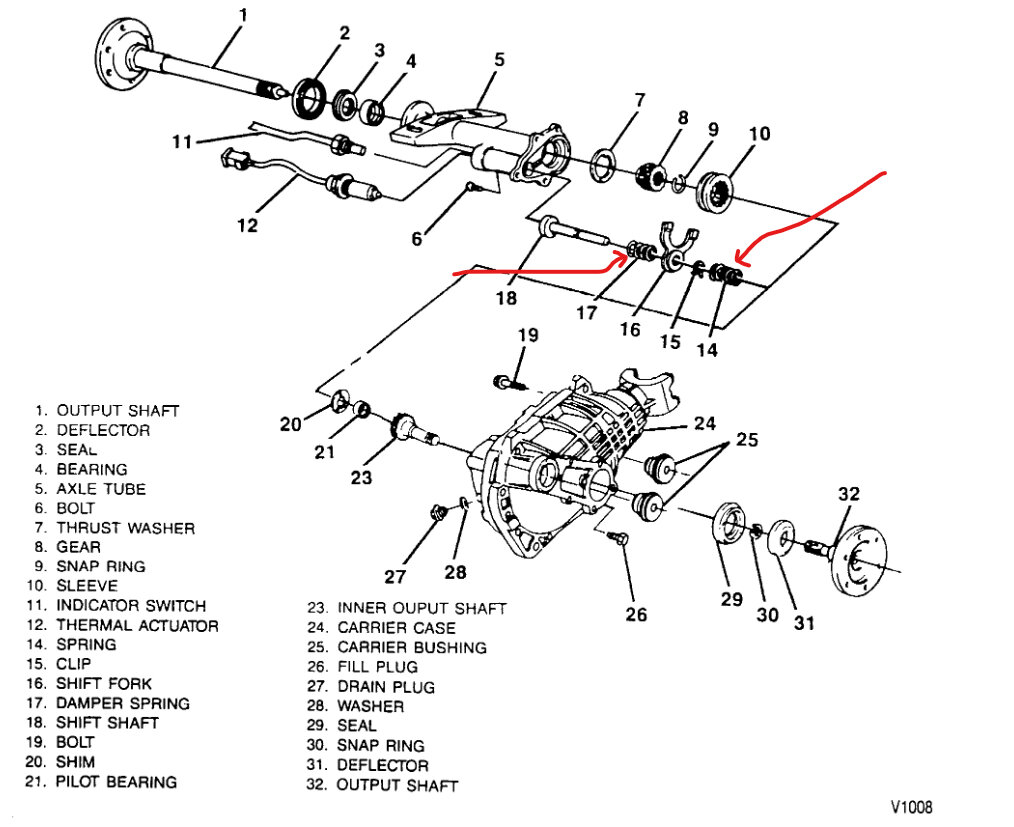

I have no lights coming on indicating that 4H or 4L are engaged. I pulled actuator...shifted w/ key on...actuator worked! Shifted back to 2H actuator popped backed in - it worked! What else could be the problem? Could actuator just be old and weak? How come the lights on the floor shifter don't come on? Could this have something to do with it?? Why would actuator work but no lights? More importantly....how come I can't get my front axle engaged for 4 wheel drive? Thanks for your help!

these are thermal actuated and have a two pin connector. When they get cold they don't like to work or one of the return springs is broken, please check the image below to see what I am talking about. Check out the images (Below). Let us know what happens and please upload pictures or videos of the problem.

You need to replace it I sell so many of these things it isn't funny. You did look in the hole to see that nothing was broken inside right. The two wire ones are thermal and the metal around it is cold so it isn't going out all the way this is why it is not engaging. It is -2 here in Idaho so you have it warm LOL.

Ok......now.....I took your advice....I replaced the actuator....sealed the threads and filled with gear oil. I still have no 4 wheel drive. The light on the floor shifter does not light up on the front axle. I replaced bulb there. I checked new actuator prior to installation...it worked fine. From what I can tell....inside the housing of differential nothing is broken. 4 wheel low works on rear axle thats is. Front axle in both 4L and 4H is definitely not engaged. When I punch it in the snow only the rear tires are spinning. What would suggest at this point. Oh....I really do appreciate the time you are spending with me on this situation. Unfortunately I don't have alot of money so I am trying to make this repair myself. It is adding up already with the actuator purchase, however, I know I wont need one of them at this point. Thanks for the gratitude you gave me! I now can appreciate the 16 deg. I have as compared to the neg. temps. LOL.

Wow that usually fixes them. Now do you know if the front drive line is engaged or not? There could be a problem with the shift shaft or the shift fork but that would not be very cheap to fix. That actuator is what turns the light on by closing the switch to indicate that you are in 4x4. I wonder if they are not engaging far enough to lock the front axle. Now this is going to sound really crazy to ask but is the A/C heater fuse good? It sounds nuts but this is the 4x4 fuse too. Have you checked the transfer case switch yet?

DO NOT SHIM as this can do damage and if you shim there is only one way to shim and that would make it not be able to engage this is why the actuator extends when you put in 4x4. Now never assume anything as vehicles can act different then you think it should. Now if you jack up the front end and have the 4x4 button pushed and turn the wheels by hand the does the front drive line spin? If so then your transfer case may not be locking in. I would check the transfer case switch as I have instructed and if all that checks out ok. then you need to check the linkage for proper adjustment so one step at a time here. Let me what you find.

Thanks for the good point.....fortunately the actuator would not go in with the shim! I am going to jack up the front end now and will get back to you. Thanks again

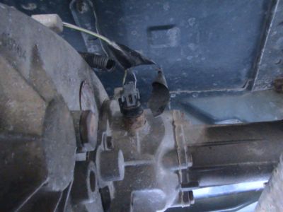

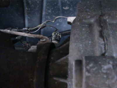

Ok....I am sending pictures of the two locations I have tested. I checked the pink/white wire and all was good. Fuses are fine. Brown wire had juice. Transfer case: I checked the switch @ the top of the transfer case as pictured and of the three wires...in 2H one had juice w/ key on and other two dead. In 4H w/ key on two wires had juice one dead (ground). I tested in both situations with connector on the switch as instructed. Other picture (rear transfer case) two wires going to this switch and neither had juice at any time. This is the switch that I was originally referring too that I claimed had no power. I am thinking that the switch you were referring too was the switch on top closest to the front driveshaft. At any rate.....here is where I'm at: The switch on top seems to be working fine (unless you tell me differently) and the switch at the rear of the transfer case (green and purple wires) has no power at any time. (I don't know if this has anything to do with our situation or not). I don't know where to go from here....please advise. Thank you
https://images.2carpros.com/forum/automotive_pictures/289178_top_transfercase_1.jpg
https://images.2carpros.com/forum/automotive_pictures/289178_rear_transfercase_1.jpg

Ok the one on top was the one to be tested and it tested fine. The one on the rear with two wires is your speedometer sensor to tell the vehicle the speed so if you speedo is working right then all is ok with it and no it won't stop the 4x4 from working.
Ok all signs of the test are pointing to the transfer case relay now. It is under the hood on the right side of the firewall near the battery junction block cover. If you want to verify that you can do a test on the front axle solenoid again you need to have the t-case in the 4x4 position attach the test light between the light blue wire and the black wire if the test light does not light then you need to check the black wire for any brakes if there are not problems found with the black wire then replace the transfer case relay. IF the light lights up then you got a bad axle solenoid and you need to take it back and warranty it. Let me know what you find.

Can I ask you a question? Their are three wires going to the actuator. Where do they go or what are they for? The thermal actuator only uses two (My guess is these are one hot/ one ground) The solenoid actuator requires three (My guess is one hot/ one ground and the other is not known)
Could something be broken in the front differential that is preventing the actuator from engaging the axles or would I hear or know something was wrong when it is moving in 4 x 4 (grinding noise)

Ok I assume that you mean the one on the t-case. that switch has three as one is ground one is power in and one is power to the front axle actuator.
Yes something can be broke in the front diff. not always will it make noise even though you would think it should. Get back to me on the relay and we continue Friday.Merry Christmas
