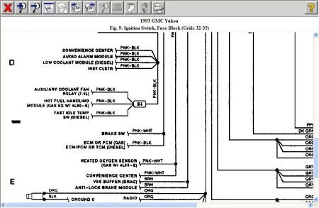

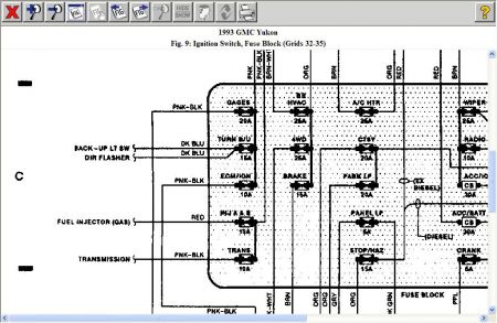

I need a wiring diagram to figure out a short without having to tear apart all the wiring harneses. This short is affecting the gagues fuse on the top left of the fuse block (20 Amp). I have isolated it to a pink/black wire going into the firewall harness. After that I have no clue.
Also my truck is really running rough at low rpm and accelerating slowly. I think it might be the wire I disconected to this harness so that I can use the gagues with out blowing the fuse. The sorry chilton manual I have has no troubleshooting charts nor a decent wiring diagram for this truck.
Any help on this would be very much appreciated.

This is as far as I can give you
https://images.2carpros.com/forum/automotive_pictures/12900_gauge1_1.jpg
https://images.2carpros.com/forum/automotive_pictures/12900_gauge2_1.jpg
