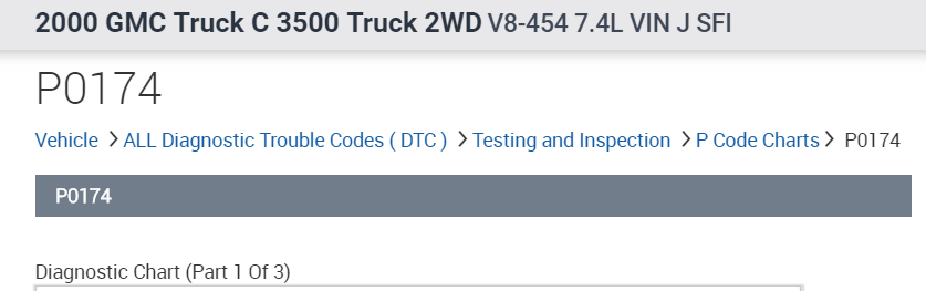

Okay, to see if you have a burnt valve or not is pretty simple, do a compression test. Here is a link for you to go to below:
Please go through this guide and get back to us with what you are able to find out. If your compression test comes back okay, we will have a factory diagnostic troubleshooting guide for you for Direct Trouble Code(DTC) P0174 that will pinpoint what is going on with your vehicle for you. We want to do one thing at a time, and take a systematic approach to fixing your vehicle.

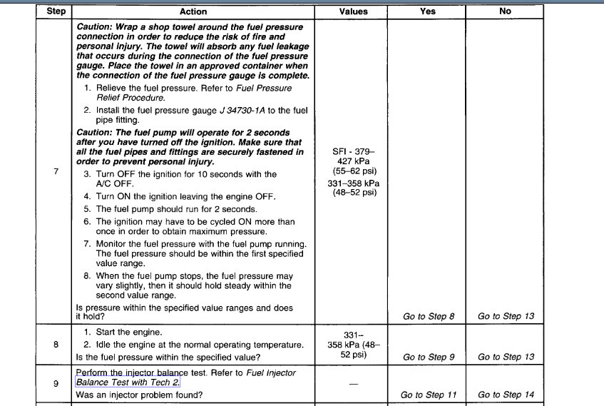

Just had a compression test, all cylinders in the 150s ("good" i was told). Said my fuel pressure is low, maybe it is what is causing it to run lean. said the lean condition could possibly cause these symptoms. I am hopeful....

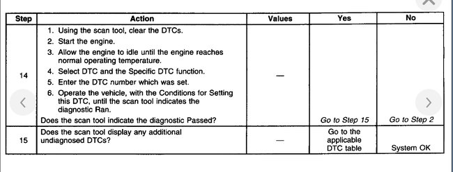

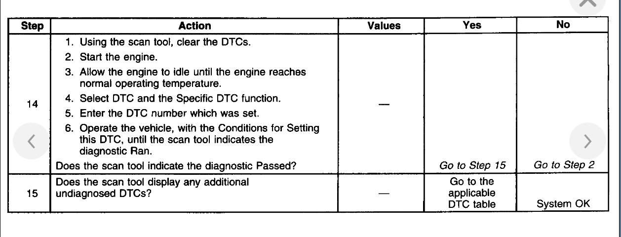

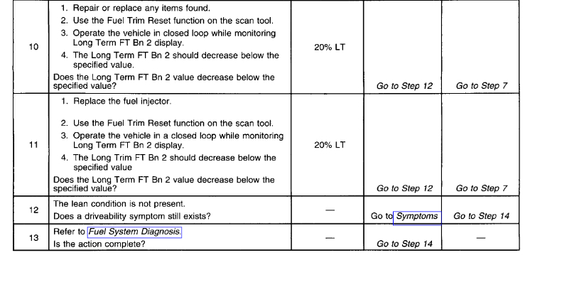

Hello again,

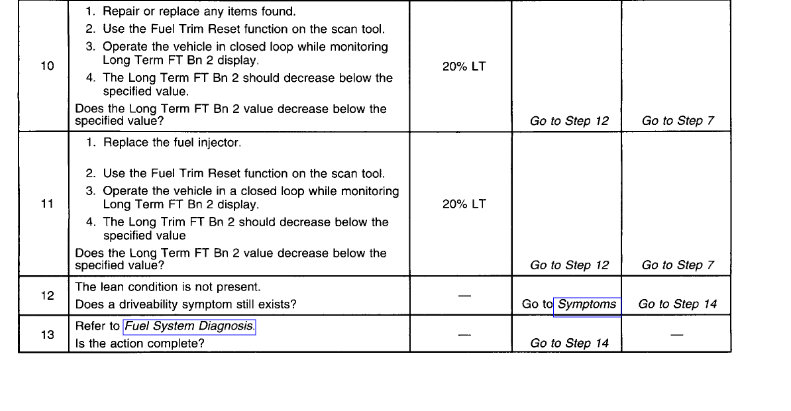

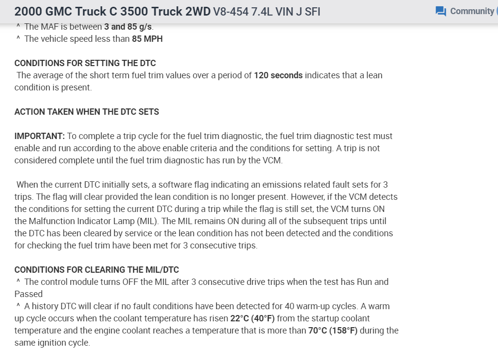

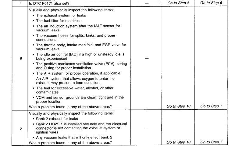

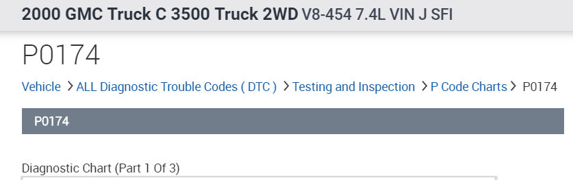

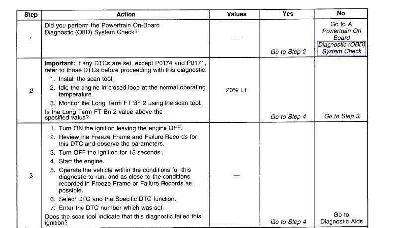

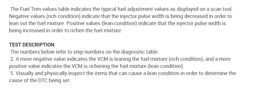

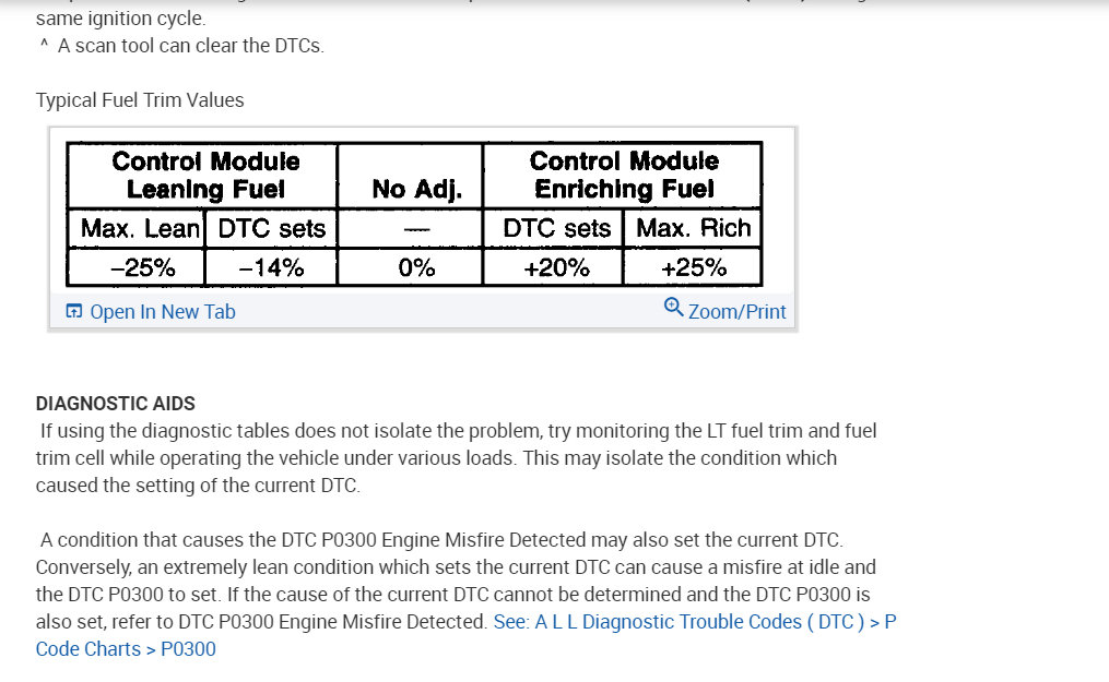

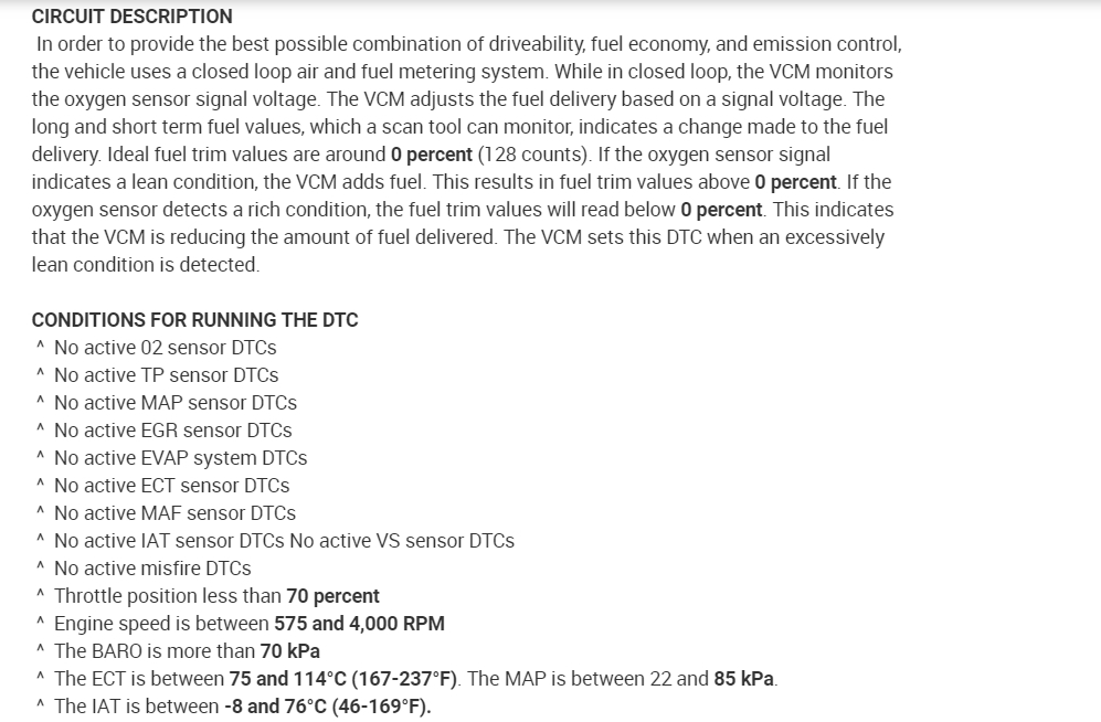

Yes, low fuel pressure will indeed cause a lean condition, in fact it is pretty much the definition of a lean condition. Pretty sure that getting that fixed will take care of the problem. Regardless I have included in the diagrams down below the factory diagnostic troubleshooting guide for Direct Trouble Code(DTC) P0174, merely for reference for you. Please go through this guide, at your leisure, and keep us informed as to how everything is progressing.

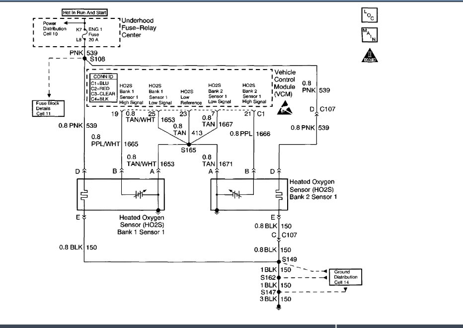

Check the wiring going to the upstream O2 sensor. By upstream I mean the O2 Sensor that is closest to the engine on the side the trash was burning on. Please get back to us with what you are able to find out.

Have it in a shop, they claim to have checked *everything* and that its "all good" except my fuel pressure is still low by like "10+ psi" and that they are confident that this has to be it. I could probably replace the fuel pump myself but unfortunately don't have the time, - having them do it is somewhat expensive but I have no choice.
I hope this is it, but if you guys disagree feel free to let me know.
It kinda worries me, didn't know/think that 10psi low fuel pressure would cause my truck to pop and run badly.

Have them check the upstream O2 sensor and wiring harness going to the upstream O2 sensor on the side that you had the trash burning on. I have seen these wires melt together just from them touching the exhaust and it will cause these problems as well. Something else to consider, if it was low fuel pressure causing this, your vehicle should also display DTC P0171 which is Fuel Trim Too Lean/Bank 1, not just DTC P0174 which is Fuel Trim Too Lean/Bank 2. The lack of fuel pressure would be spread across the fuel rail, effecting both banks, not just one. Please keep us informed as to how things progress.
