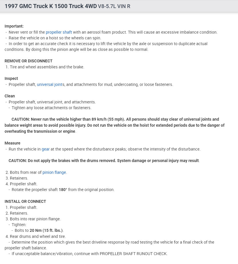

truck vibrates like your going over rumble strips.when you accelerate doing about 50, at a slow accerleration. let up on gas peddle and vibration stops.
Jan 18, 2010 at 4:31 PM
SQM
  • 6,383 POSTS

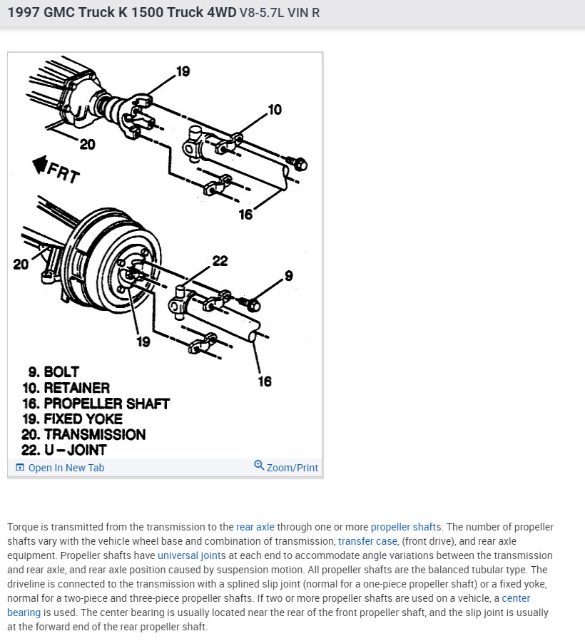

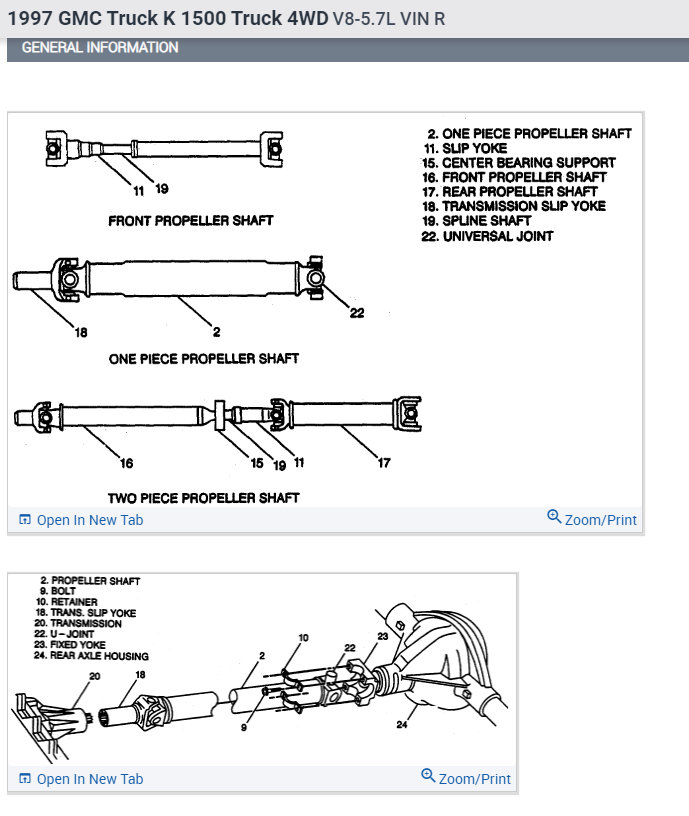

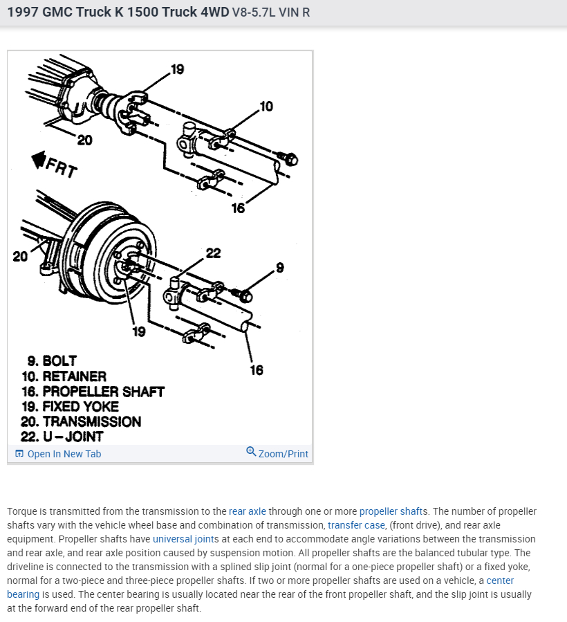

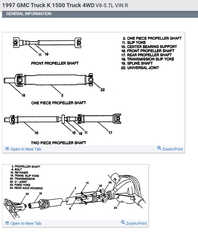

Sounds like an issue with the drive shaft. There could be a few different reasons why.
The best course of action would be first to do a thorough inspection of the drive shaft.
Inspect the U-joints, the yoke. Also, the mounting point for the drive shaft.
It could be due to any one of those components.

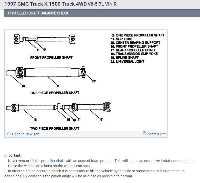

This can also happen due to an imbalanced propeller shaft/drive shaft. Which will vibrate, especially under load.
https://www.2carpros.com/articles/how-to-remove-a-drive-shaft
I have attached diagrams for the drive shaft as well as how to check for imbalanced shaft below.
