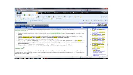

P0341 diagnosis:
https://images.2carpros.com/forum/automotive_pictures/108325_p0341_1.jpg
