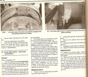

how do you get the retainer clip off of the brake switch?

here are some instructions, if you can't see them as I am having some problem with my computer , save them in pictures , then resize for them to be clearer.
https://images.2carpros.com/forum/automotive_pictures/54223_brake_light_switch_1.jpg
