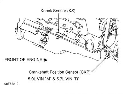

What can I do to fix the code p1345 I think that it. It said crank sensor and camshaft sensor not corrlating. And how much play os supposed to be in the distributor it seems to have alot of play

Hi
Try and move rotor any movement? If yes then dist is faulty. If no check for wire chaffing or loose connections. Also worn timing chain can cause code. Without a scan tool to test with your down to hunt and replace.

Well I took off the rotor cap and button to inspect the place where the camshaft sensor and where the button mounts I turned it a little. It can also lift up about an 1/8th of an inch didnt know if that was normal. But the timing chain I would have to remove the front assembly and balancer to see it right?

With rotor on can you move it back and forth? To check chain rotate engine by hane ratchet on crank bolt to TDC with cap off note position of rotor. Turn ratchet countyer clockwise till rotor moves if more than 10degs then chain has took much slop.Chekout cranksensor they tend to go bad. See diagram
https://www.2carpros.com/forum/automotive_pictures/198357_Graphic_361.jpg

No it doesnt move with the cap on. But it moves with the button on. I will let my mechanic check the slack in the chain for me thanks alot
