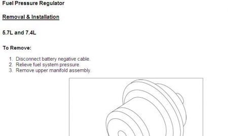

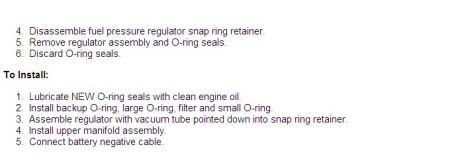

I just installed my 3rd fuel pump into my 1998 gmc 4x4 suburban , with an automatic trans, and a 5.7L 350 cu. in. engine. Also i noticed that the fuel filler neck had a rusted pinhole in it so i replaced it. My check engine light went off when I was don (it had been on). My question is what is the proper fuel pressure for this motor, and could my problem possibly be caused by a bad pressure regulator and if so where is it located and what is the procedure for replacing it?

https://images.2carpros.com/forum/automotive_pictures/170934_gmc_pressure_regulator_1.jpg
https://images.2carpros.com/forum/automotive_pictures/170934_gmc_pressure_regulator_1_1.jpg
Fuel pressure, key on engine off, 60-66
