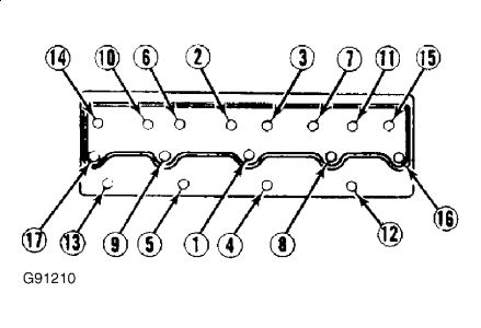

What is the torch sequence for removal and install of head for a 6.2 liter diesel engine?

Tighten cylinder head bolts in three steps. first 20 Ft. Lbs , then 50 Ft. Lbs. and finally an additional 90 degrees
