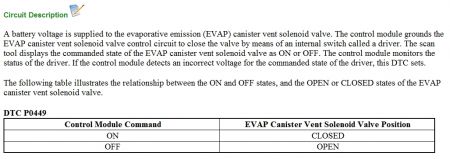

I have a code P0449 hOW DO i FIX IT

https://images.2carpros.com/forum/automotive_pictures/261618_Noname_2533.jpg
