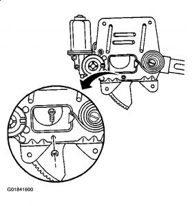

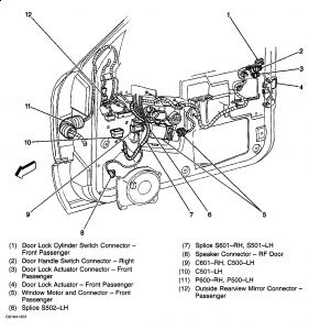

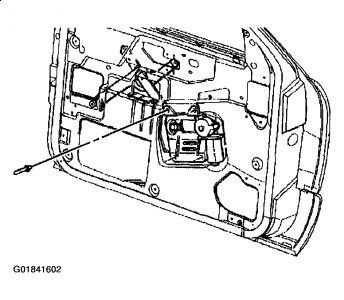

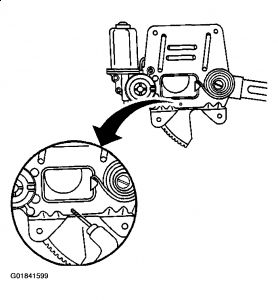

how do I remove window motor
Sep 19, 2009 at 8:18 AM
DOCFIXIT
  • 18,828 POSTS
Remove door panel
https://images.2carpros.com/forum/automotive_pictures/198357_Graphic_141.jpg
then drill out regulator rivets
https://images.2carpros.com/forum/automotive_pictures/198357_Graphic_5_7.jpg
when regulator out drill out reg revit
https://images.2carpros.com/forum/automotive_pictures/198357_Grafic_3_41.jpg
remove motor from regulator
