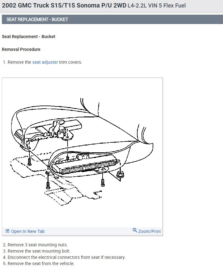

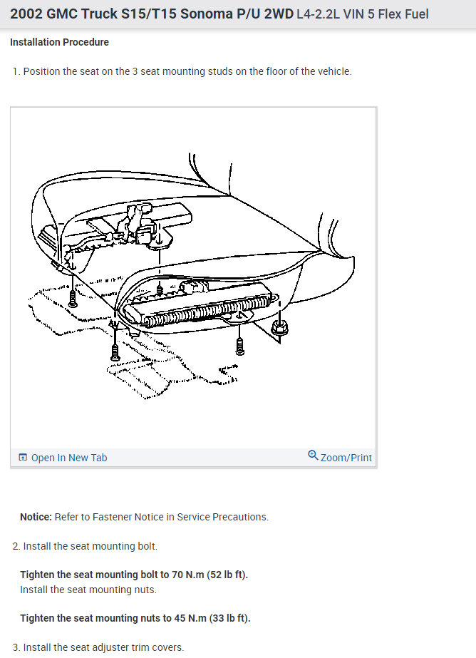

The seats out of any of the other vehicles are not interchangeable.
As the mounting components are different for these vehicles.
The best option you have is to get the cushions replaced with better supported materials and reupholstered.
There are many upholstery shops that do custom seats to fit their customers need. They will be able to custom make a cushion according to your preference.
