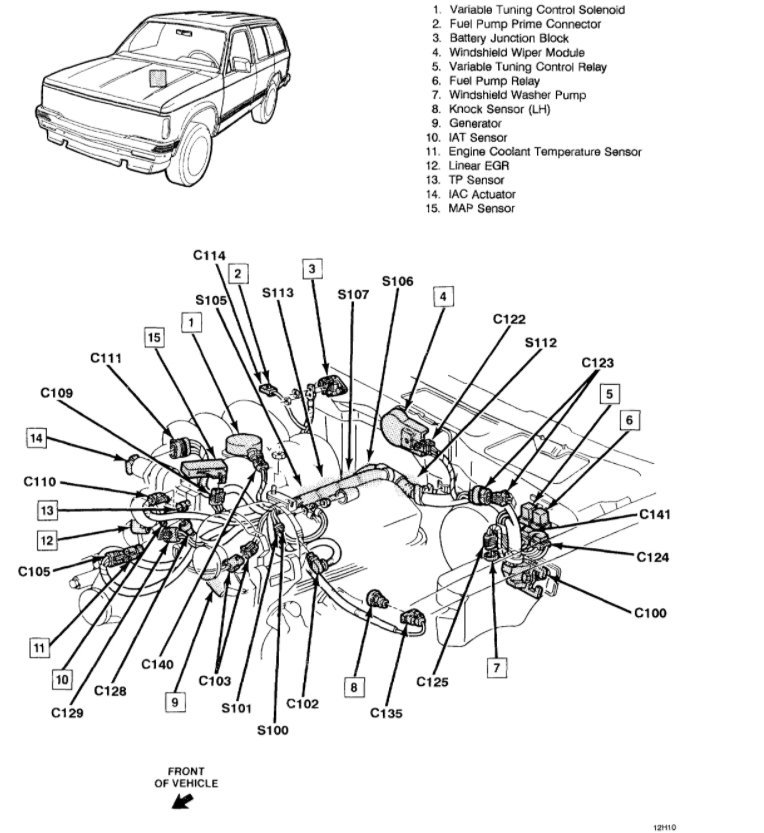

BEAVERWELCH
engine surges while idling or running down the the road. has new wires plugs rotor cap rotor button no vacuum leaks. new manifold temperature sensor valve . fuel is clean, have changed the fuel filter twice.
Dec 2, 2020 at 1:20 AM (Merged)
  • 55,399 POSTS
Hey BEAVERWELCH
This sounds like a classic MAP sensor problem. This guide can help as well
https://www.2carpros.com/articles/engine-surges
Check out the diagrams below to show you on your car. Check out the diagrams (Below). Please let us know what happens.
