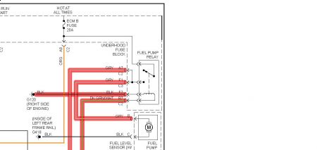

truck cut off, fuel pump was replaced, found to be bad. Fuel pump wont prime, can jump fuel pump with spare batt. and truck will start. Switched fp relay with horn relay and horn still works. Fuses under hood and dash are good. Had to splice new harness for the fuel pump, continuity ck good on splices.

The ECM B fuse 20amp powers the fuel pump relay and the ground for the relay is on the right side of the engine

I have 12v momemterily on gray fuel pump lead, used jumper to make second ground to frame from fp ground. still nothing. will ck on the ecm gound u mentioned
