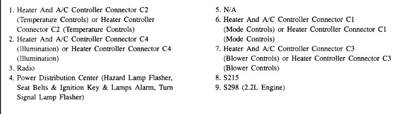

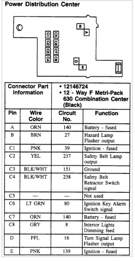

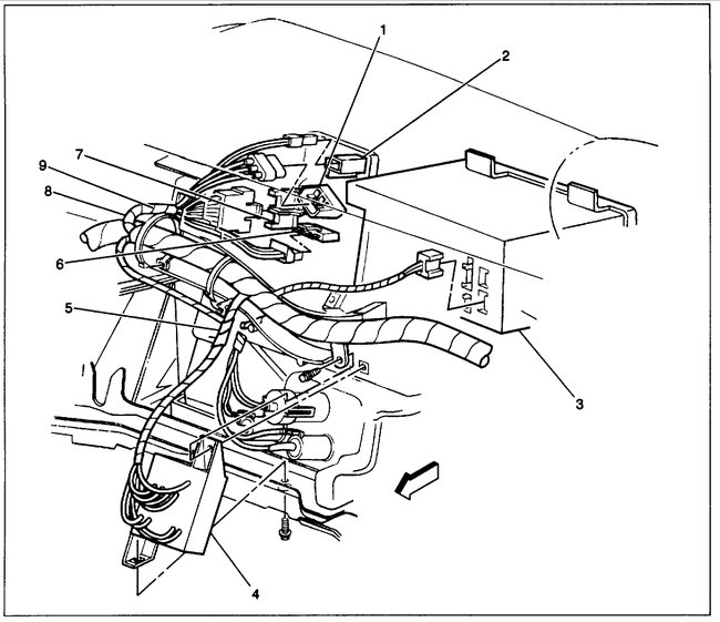

Where are the flashers located behind glove box?
Nov 17, 2008 at 6:34 PM
  • CAR REPAIR CONTRIBUTOR
  • 75,992 POSTS
The flashers are located in the power distribution box here are diagrams below to show you what I am talking about.
