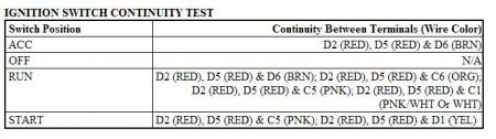

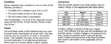

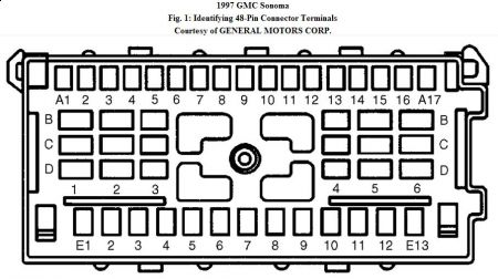

Hi afields77, The symptoms described are most likely caused by a bad ignition switch, which is known to fail quite often. When key is turn to ON position, power supply to the dash is missing, meaning all other components would not work and this would not allow you to start the vehicle. Here are the testing procedures. Turn ignition off. Disconnect steering column switch 48-pin connector located on steering column. Using DVOM, check for continuity between specified terminals with ignition switch in specified position. See IGNITION SWITCH CONTINUITY TEST . See Fig. 1 . If continuity does not exist as indicated, repair as necessary.
https://images.2carpros.com/forum/automotive_pictures/192750_IgnitionSwitch97GMCSonoma_1.jpg
https://images.2carpros.com/forum/automotive_pictures/192750_48PinGMCSonoma_1.jpg
