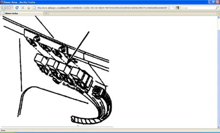

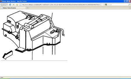

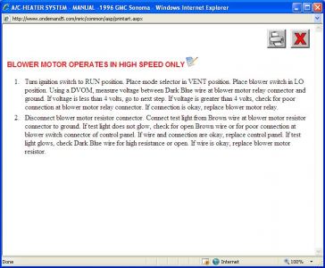

Changed blower motor with new motor fan only works on high

Have you checked the blower motor resistor yet?

The truck belongs to a friend that I am trying to help. This is what I thought it might be but wasn't positive. How do you actually check it do you ohm it out and how?

https://www.2carpros.com/forum/automotive_pictures/416332_1996_gmc_sonoma_blower_motor_1.jpg
https://www.2carpros.com/forum/automotive_pictures/416332_1996_gmc_sonoma_blower_motor_part2_1.jpg
https://www.2carpros.com/forum/automotive_pictures/416332_1996_gmc_sonoma_blower_motor_part3_1.jpg
I posted the location's of the resistor and the relay there in the engine compartment i also posted the trouble tree for the blower only work's on high.I also emailed you the trouble tree.
