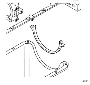

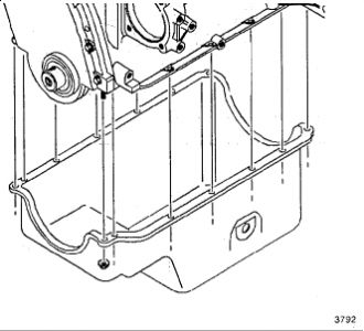

How do I remove a oil pan from a 1996 GMC Sonoma?

ENGINE OIL PAN REPLACEMENT REMOVAL 1. Remove the engine. Refer to Engine Replacement. See: Service and Repair
https://images.2carpros.com/forum/automotive_pictures/12900_op1_1.gif
2. Remove the oil pan bolts.
https://images.2carpros.com/forum/automotive_pictures/12900_op2_1.jpg
3. Remove the oil pan nuts.
https://images.2carpros.com/forum/automotive_pictures/12900_op3_1.gif
4. Remove the oil pan. Use a narrow putty knife in order to separate the oil pan from the engine block.
https://images.2carpros.com/forum/automotive_pictures/12900_op4_1.jpg
5. Remove the oil pan rear oil seal. 6. Clean the sealing surfaces of the oil pan and the engine block. INSTALLATION
https://images.2carpros.com/forum/automotive_pictures/12900_op5_1.gif
1. Apply a 5 mm (0.193 in) diameter bead of RTV sealer or equivalent to the oil pan side sealing flanges.
https://images.2carpros.com/forum/automotive_pictures/12900_op6_1.gif
2. Apply RTV sealer or equivalent to the oil pan surface that contacts the timing cover.
https://images.2carpros.com/forum/automotive_pictures/12900_op7_1.gif
3. Install a new oil pan rear seal. Apply a small amount of RTV sealer or Equivalent to the oil pan rear seal ears. 4. Install the oil pan. 5. Install the oil pan nuts. o Tighten the oil pan nuts to 10 Nm (89 inch lbs.) 6. Install the oil pan bolts. o Tighten the oil pan bolts to 10 Nm (89 inch lbs.) 7. Install the engine. Refer to Engine Replacement.
