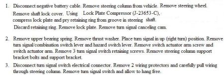

1995 GMC Sonoma 6 cyl Four Wheel Drive Automatic
I need to replace the hazard light switch but can't manage to find out how to get at it the best way, i can remove the bottom cover of the steering wheel but there is still no axcess to the base of the switch. I can not manage to get the top cover of the steering wheel off, what should i do? the hazards are constantly onn and always draining the battery.

Is this the tilt or non-tilt type of steering column?

non tilt steering wheel.

See if these steps will get you to the hazard switch..
https://images.2carpros.com/forum/automotive_pictures/261618_Noname_639.jpg
