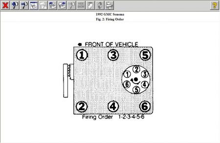

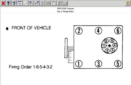

I am replacing the spark plug wires. All of the old wires have been removed and I need to know where on the distributor each wire goes.
Friday, April 25th, 2008 AT 5:41 PM
  • 75,992 POSTS
See below
2.8L engine

4.3L
