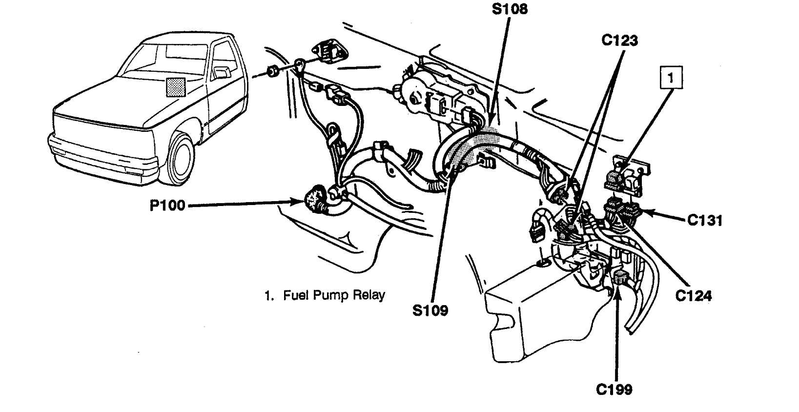

Here is the fuel pump relay located?

The fuel pump relay is located on firewall, left of brake booster. HEre is a guide to help you test it with diagrams below to show the location.
Check out the diagrams (Below). Please let us know what you find.
