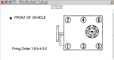

I CHANGED DIST. CAP AND MUST HAVE CROSED THE WIRES SOME HOW. I NEED A PICTURE DIAGRAM SHOWING ME HOW TO SOLVE THIS PROBLEM.

There you go-Good Luck
https://images.2carpros.com/forum/automotive_pictures/12900_fo_68.jpg
