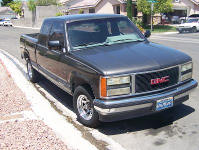

I am trying to figure out how to remove my fuel tank from my 1991 GMC P/U Sierra extended cab with 4.3 eng. I took off the bolts to the straps but it still won't come out. I know my fuel pump is bad and I just bought a new one. This truck has 150,000 miles on it. Nothing on this truck is easy to repair. It reminds me of my 1996 sebring convertable. A nightmare. Bill Warren[img:683563bbd8]http://www.2carpros.com/forum/automotive_pictures/57655_bill_w_truck_6_1.jpg[/img:683563bbd8]
