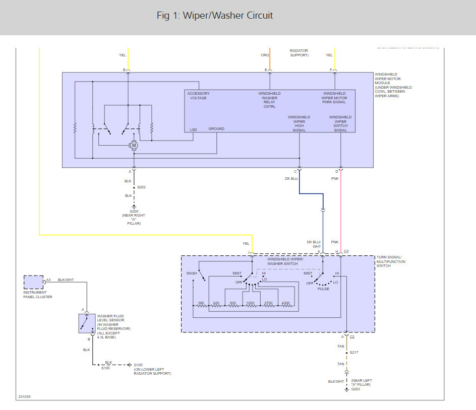

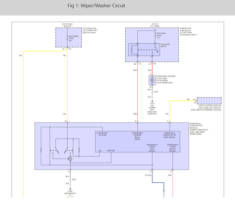

The wiper motor wont shut off even w/ the ignition off, the intermittent speeds dont work, only a regular speed and high speed work. Washers work OK, directional and high beam works OK which are controlled on the same lever that controls the wipers. I took a 12V test light and connected to the connection that goes into the wiper motor. I got power from the black wire and the black/white wire but I got nothing from the Purple , DK Green or yellow. Should I get some power from any of these 3 colors when I have the ignition on and the wiper switch on one of the intermittent speeds or high speed? Also I can hear a relay making noise when I first put the high speed on. Where are the relays located for the wiper motor . I can only locate the 25A fuse for the wiper motor. Also there is a M located on the wiper motor diagram , is that M for the module that is built into the the wiper motor and could that be my problem?

I would suspect the light and corresponding code was created by your checking. The relays in the underhood fuse block are WIPER CONTROL PCB, and WIPER SPEED PCB, and there should be a legend under the cover that illustrates the fuses and relays. It is possible that the relays are not serviceable and part of the fuse block, otherwise known as underhood bussed electrical center(UBEC). The wiper switch is a direct input to the body control module, and it is responsible for controlling the wipers based on requests, so it is a possible fault. With a scan tool, you could view BCM data, and determine if the BCM is showing that the wipers are being requested. You said in your first post, that you had power on the black/white wire, is that correct, and was the connector connected to the motor? If it was disconnected, you should not have had power on that wire, it is hard wired to ground. The purple wire should have had power, but only in high speed. You might be able to isolate this to a faulty UBEC, by either disconnecting the BCM, or removing power to it, here is what it shows for location;
Body Control Module (BCM)
On the lower left side of the I/P to the left of the steering column
Before disconnecting the BCM, try this first, It seizes to amaze me what it can correct. Disconnect both battery cables, and short them together either by touching or using a jumper wire. Leave it connected for a minute or so. Reconnect the battery, and check the operation. If nothing has changed, disconnect the BCM connector X1(light green) and see if the wipers stop. This houses the inputs from the wiper switch. Get back to me with the results.

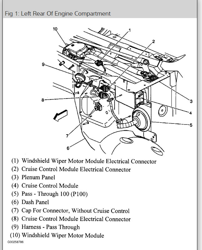

This is a common problem it sounds like the wiper module is not working correctly here is the location so you can swap it out and the wiper wiring diagrams so you can see how it works. Check out the diagrams (Below). Please let us know what happens.
Jun 17, 2019 at 4:54 AM
