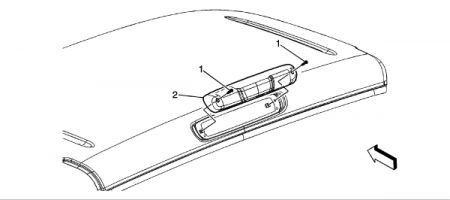

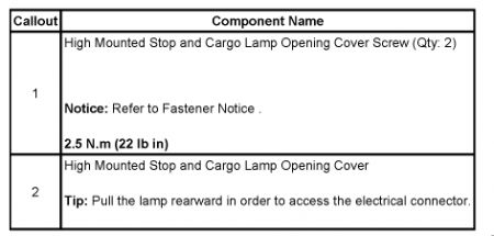

This just started today. Still has original bulbs and nothing has been tinkered with. Light stays on constantly and I don't know how to get it off.

check for faulty relay to the high mount light
