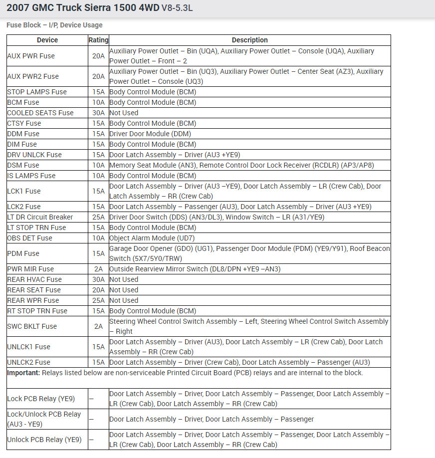

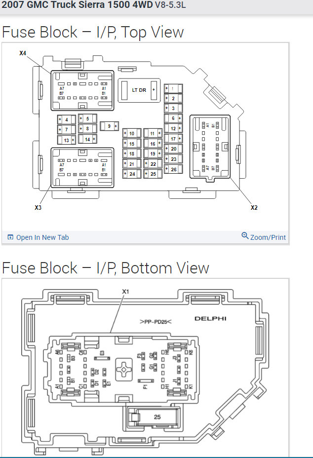

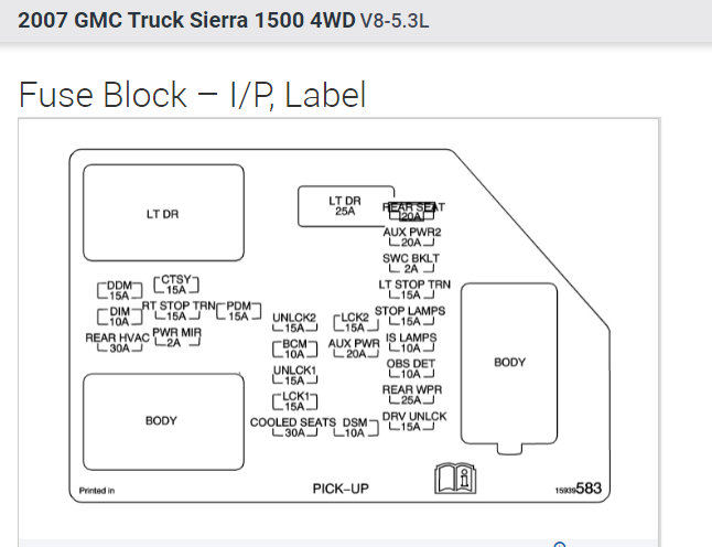

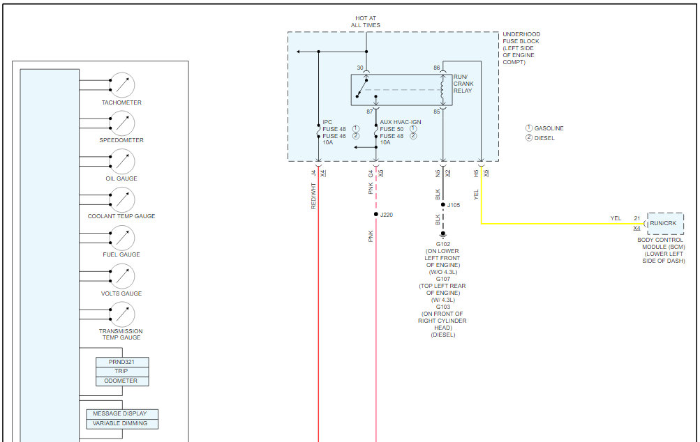

It is likely a blown fuse.
There should be a 10A fuse in the fuse box on the left side of the instrument panel.
If the fuse checks out, then the issue could be a faulty wire for the gauge cluster.
I have included the wiring schematics for your reference.
